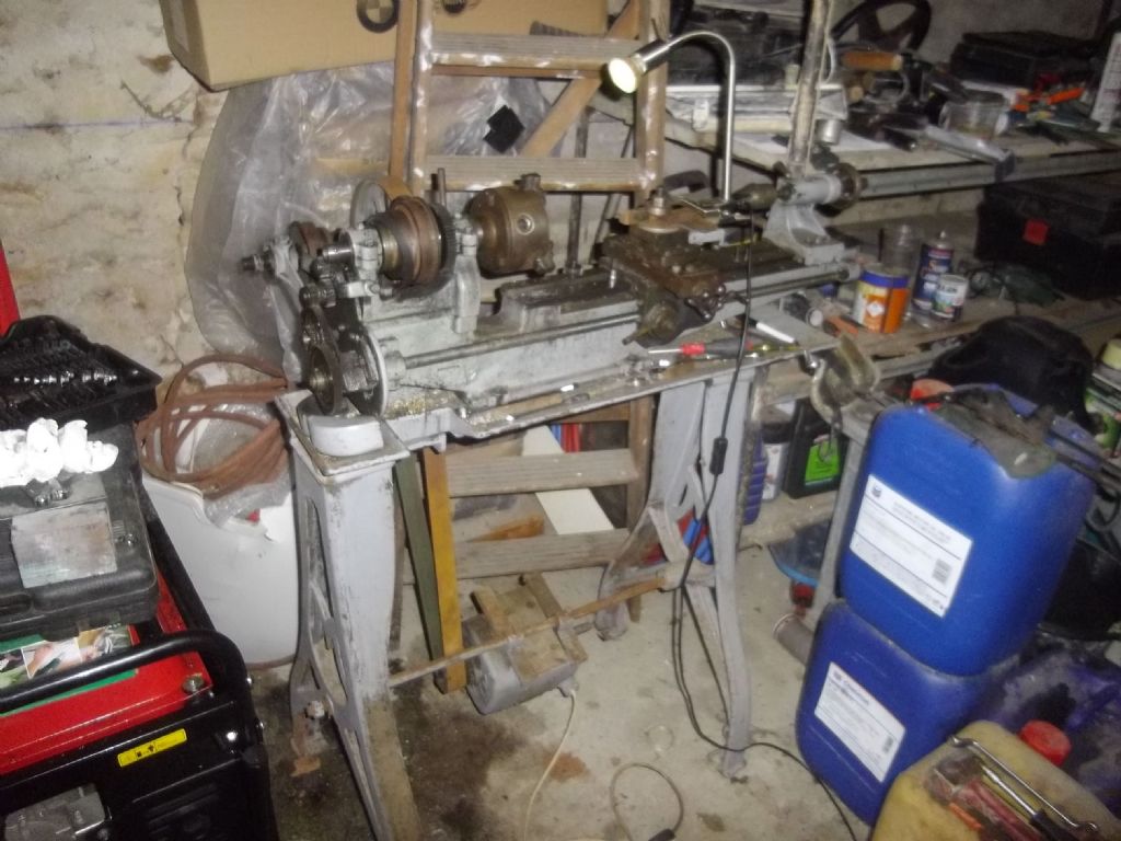

        First a picture of the lathe:
        As you can see it's the model with the motor hanging under it.

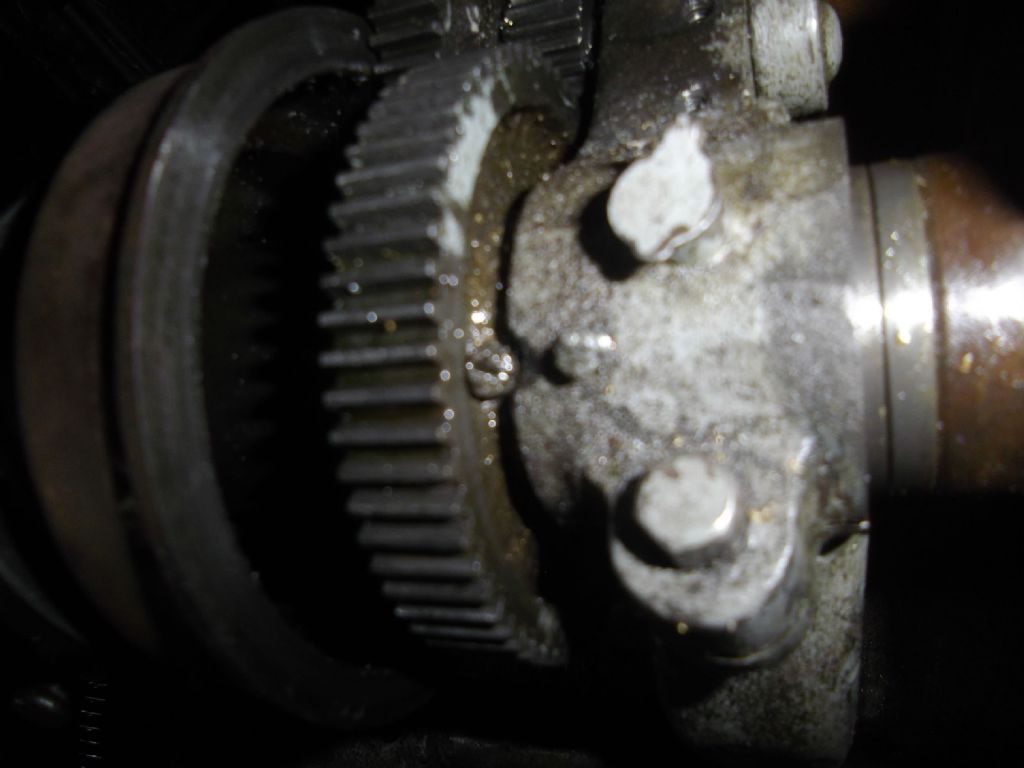

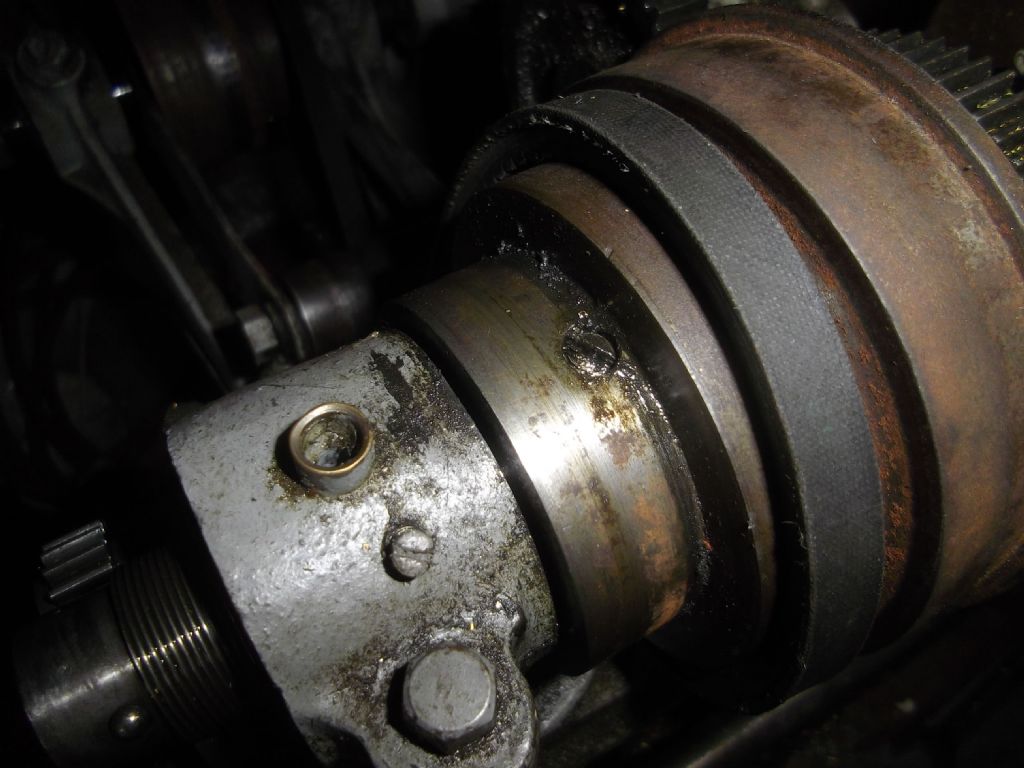

        Grub screws at the front side:
        Grub screws at the back side:

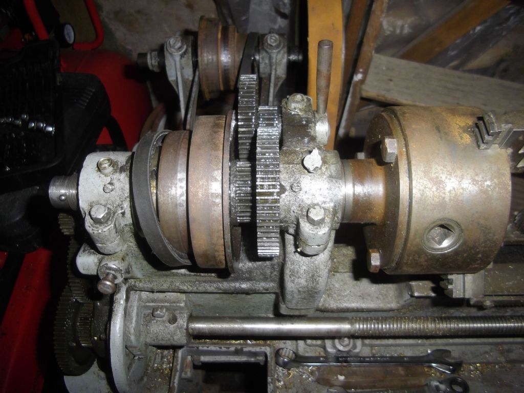

        And a picture of the whole gear:
        What am I missing here?

          Hello Nick,
          Make sure the motor is propped up to keep the weight off the spindle.
          Nip up the grubscrew for the 65T bull gear, engage the back gearing and take off the chuck, it will all be much easier with that added weight off the spindle. Undo that grub screw again and disengage back gear.
          Slacken the spindle bearing cap screws so that they no longer squeeze the bearings and with either a rubber faced hammer or wooden mallet tap the spindle forward from the change wheel end to withdraw it over the bed.
          That should be sufficient to remove it. Don't lose the thrust bearing or it's washer once it is out and remove the stepped pulley cluster as it comes free. There is a woodruff key linking the spindle and pulley bore and also needs to be pulled out, it won't go through the bull gear. A pair of nail pincers will extract it cleanly with a good grip and a little leverage from one side.
          After that the spindle is clear to pass through the bull gear and out of the chuck end bearing

            Now I just got one problem, the gear with the grub screw … this one:
            is stuck to the axle. I think the previous owner ran it without it being properly locked in place, from the friction possibly been produced it welded itself to the shaft. I can tell it was not locked by looking at the grub screw, it's worn on the top side telling me it was turned all the way out when he turned the power on.
            There is no way at this very moment I can get it loose. I do assume it has to turn free when that grub screw is loosened up.
            Please correct me if I'm wrong here.

              Oh dear. You are quite right in your assumption, the grub screw normally grips on a rather insubstantial flat on the spindle and the gear should be free to turn when the grub screw is loosened. With the gear having turned with the grub screw over-riding the flat the spindle will be chewed up to some extent below. The gear will not be welded on, it is in cast iron and the rough surfaces in contact are giving you the trouble you report.
              You can still knock it through, you will just have to grit your teeth and shut your eyes to do so !!
              Perhaps better might be to feed a length of studding [ all thread, I suggest M10 ] down the spindle to a thick washer at the change wheel end with an M10 nut outside it and find a suitable section of hefty tube to contain the nose of the spindle and at least a couple of inches more, fit a good section bridge with a hole for the thread over that and another M10 nut and use the arrangement as a drawbar to pull it through.
              Once the damaged section of the spindle is free of the gear you now need to protect the white metal bearing shell in the bearing cap as much as you can. I suggest you remove the clamp bolt for the bearing and push a wedge into the gap to spring the bearing open a little for added clearance. Be careful with this, the bearing caps are cast iron and will only tolerate a little of that treatment. Try if you can see the damage to align ridging with the gap in the bearing shell or if you can with a little flat Swiss file dress of the worst of it before to push or pull it through the bearing.
              Now you should be able to extract the spindle as I described before. The gear bore may well be jiggered but the spindle will dress with care to get the high spots down and it should be OK. I have a replacement gear if you need it
