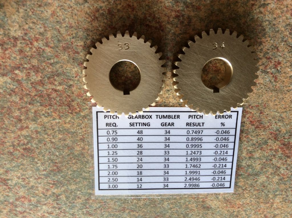

                  John, It may well be worth looking at this post before buying the Myford metric screw cutting kit — here you need only a couple of gears !
                  https://www.model-engineer.co.uk/forums/postings.asp?th=125630
                  I have used both systems, bought the kit many years ago before the "new" simplified system was devised, now I use the new system — OK its not exact in some cases but absolutely fine for most jobs .

                    John B, somewhere here there's a thread that links to tables of change gears needed to make metric threads without using the "exact" gears. The resulting errors are minimal for all practical purposes, likely less than the error in the leadscrew itself. Also I think there's a spreadsheet to calculate them if the table doesn't cover what you need.

                                    @bernardtowers37738
                                    I think as most people are saying that 33/34 tooth gears should cover most of what you should need0e82a5ed-86db-427f-b984-a386643563aa.jpeg

                                                Those two gears in the picture as posted by bernard tower was sold by John Stevenson years ago, perhaps some one else does so now. If you have a dividing head they can be easily made at home. There has been quite a discussion on "here" in the past about gears and Brian Wood's book on screw cutting. John
