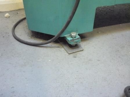

          I just use some M10 (I think) bolts nuts and washers with a scrap of Ali to spread the load, like this.

            Thanks John, that's just the sort of help I needed. I'm picking it up Sunday so I'll have to look at the hole size.

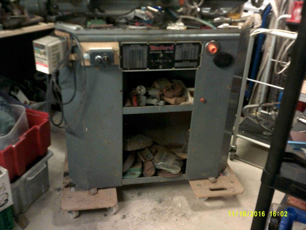

                    Andy – I have 4 different sets of machine feet on adjustable uprights but all too large for the Myford cabinet lugs. I decided that mobility and stability were a useful add-on so popped mine onto a pair of Lidl's finest 'Pensioner's Skateboards'!!cheekysee photos …img_9115.jpg
                    The second shot was taken a couple of minutes ago – the camera setup is rubbish!!
                    rgds
                    Bill

                        I'm using something similar to these on my Warco copy in the new workshop **LINK** which allow for the uneven concrete floor.
                        Beware, the Myford is a bit top heavy, with a tendency towards the rear. I've only used adjustable feet in the short term, as I'm not sure where the lathe will finally be sited when its bigger cousin arrives.
                        In the other workshop in Sheffield, my original genuine Myford is rawlbolted to the floor with appropriate shims.
                        My Dore Westbury mill is on an angle iron cabinet, with a couple of further horizontal lengths of angle iron at floor level. These carry 4 heavy duty castors, with another set of these adjustable feet outboard of them. It means I can move the mill round, and then wind down the feet for stability.
                        Bill

                                Solid packing is always to be preferred. Slate is very good as you can split it to make various different thicknesses.
                                If you have ended up using bolts keep the projection down to 1/4 in or less and fit a locknut.
