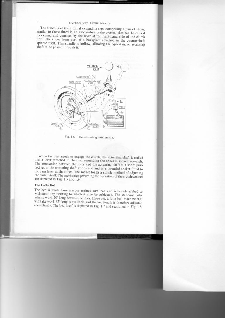

      I have a Myford ML7 lathe with a 1466 clutch unit fitted, this worked very well until two weeks ago. Mechanically actuating the clutch lever does work the clutch as required, a strip down shows the lining are in good condition however no adjustment will disengage the drive to the head stock. In short the only way to stop the chuck is to turn off the motor electrically. Could anyone please advise a solution to the problem. Thanks in advance Richard

          There is a small pin that engages with the operating arm in the clutch boss, it sounds as though it may have fallen out.

            Welcome to the forum, I hope someone can help you. There are two versions of the clutch, I don't know which is which from the 1466 identifier
            Is the clutch the older version with the expanding metal horseshoe shaped piece inside the pulley cluster on the spindle, or the more recent cone clutch type that is drawn into the two stage countershaft pulley driven by the motor? From your description it sounds as though a spring or link has failed

              The clutch unit is the expanding brake shoes type, all parts are there and it works as a unit in its own right, however with clearance on the shoes, (non drive) I have permanent drive and stop the chuck by switching off the motor.

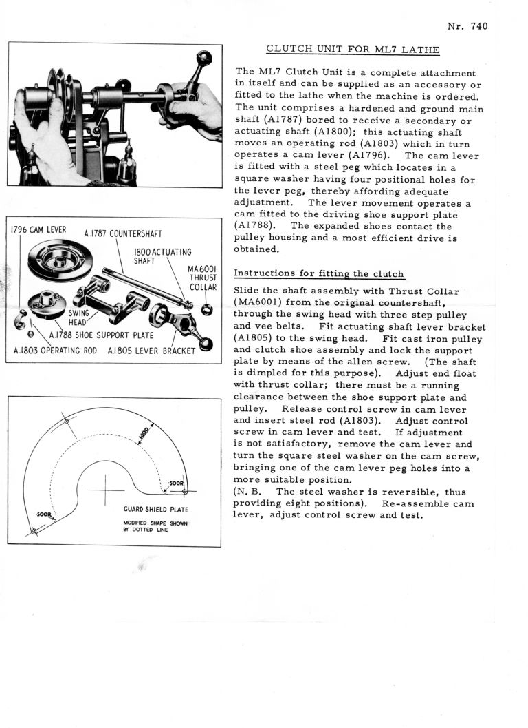

                Brian, with respect, I think you're describing the clutches on the Super Seven, Richard asked about the 1466 clutch on the ML7.
                Richard, when the clutch is disengaged, the 'outer' member of the clutch, which is combined with the belt pulley (item 5 on the exploded diagram, page P) , should run freely on the inner part which is keyed to the counter-shaft (item 38). Yours isn't running freely so my best guess is that there's been a lubrication crisis and the two parts have seized!
                I suggest that you try injecting some penetrating oil (e.g. Plus-Gas if you can find it) and try to rotate the big pulley while holding the counter-shaft cone pulley – put the second belt on to the largest section of the counter-shaft cone pulley and grip the two spans of the belt together to act as a strap wrench.
                If that fails, it sounds as though you'll need to dismantle.
                Do you have the ML7 user handbook? I fear that the clutch end of the exploded diagram on page P isn't as clear as one might hope!!

                  #223018
                  Robbo
                    @robbo
                    ml7 clutch-2001.jpgThese pics from my album might help
