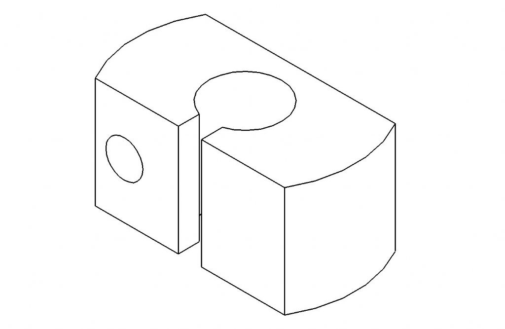

                                    While waiting for a bit of sunshine to warm up the garage, I thought I’d post a quick picture to go along with my last posting.
                                    It’s more about coming up with an acceptable shape while dodging the hinge screw-holes, and to maximise the size of the key handle.
                                    The brass hinge was actually coated with a clear varnish (probably polyurethane), which helped a little with marking out.
                                    We’re getting a bit of midday sunshine, so after lunch I’ll get to work with saw and file.

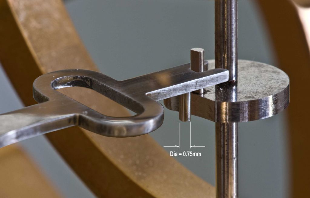

                                          First, I have to say that last night while watching TV, the clock was ticking away merrily in the background albeit at twice its intended speed. From the vicinity of the clock, there was a sudden `clatter’. Actually, clatter is a bit too strong a word because the noise was that of a pin dropping. There was a noticeable change of clock beat too, although it was still running but at a slower rate.
                                          When I investigated, the clock was ticking but with less obvious vigour by way of the balance wheel and escapement. Peering closer, I could see that the taper pin (actually a piece of sewing needle) was missing from the bottom of the spring. This pin is 0.82mm diameter, has a flat along one side, and is wedged into the balance spring collet to attach the spring to the balance wheel arbor. Here’s the collet.
                                          The split collet is a friction grip on the balance wheel arbor, while the smaller hole accepts the bottom end of the balance spring, and the 0.82mm pin (sewing needle).
                                          Although the clock was still ticking, it was clear that being loose, the spring could not offer the same stiffness, and was perhaps rubbing against itself or slopping around in the collet hole. Some of this terminology can be reinterpreted, but I won’t go down that path. As expected, the clock eventually stopped, but the experience gave me additional confidence that the escapement was not as tight as it once was. Previously, I had needed to relieve each mating bit of the escapement to ensure `freedom without shake’, as the books tell us.
                                          Here’s the lever escapement. The 0.75mm pin in this picture is the guard pin, not the 0.82mm pin which grips the spring wire in the collet which would normally appear on the 1.5mm diameter arbor (ie. the main `shaft’ running top to bottom in this view).
                                          Upon reflection, it is clear that the pin doesn’t fit properly because I made it for a spring with 0.2mm diameter wire, not 0.28mm as per the spring sent to me by a very helpful ME gentleman who knows who I’m talking about.

                                                      In case you are following my very slow progress, I have added three more pictures to my album – John Stevens Skeleton Clock Part 1. There are now 30 pictures in this album.
                                                      The new pictures show the three essential elements which are a part of the skeleton clock `coming alive’.
                                                      The fusee and barrel can be seen connected together via an 80lb (36kg) breaking strength braided fishing line. It was a nice stroke of luck that the line was yellow. It seems to go well with the brass.
                                                      During winding, the line is transferred (upwards) from the barrel to the fusee at a decreasing rate, thus providing a type of torque compensation as the main spring approaches being fully wound. I’m not convinced that the profile of the fusee, generated by a 2″ radius, accurately compensates for the increasing main-spring torque. But it’s going to have to do, cos I won’t be making another. However, while I was winding it up completely for the first time, I could feel the compensation taking place.
                                                      Also visible in this picture, although not easy to determine, is the stop-work mechanism designed to prevent over winding, and thus avoiding having the line drop off the end of the fusee. It is identified by the notched steel arm pointing away from the camera. As the line is wound onto the fusee and travels towards the front of the clock, the spring-loaded steel arm is deflected into alignment with the snail-shaped hook, just visible under the small end of the fusee.
                                                      Although concealed within the `great wheel’, there is a blued-steel circlip-shaped spring called the maintaining spring. This provides continuing power to the clock during winding. While it is not obvious, there are 29 items (including screws) which make up the entire fusee mechanism.
                                                      The next picture shows each of the important parts of the escapement.
                                                      I deliberately chose a long exposure time to display the movement of the escapement. Hence the reason for the blurred image. There are already pictures in this album showing this part of the clock before the clock came to life. The oscillation of the lever is just visible as a double image above the fifteen-toothed ‘scape wheel. At the top of the picture is the over-stiff spring, responsible for the fast beat. It is made from 0.011″ (0.28mm) diameter wire, whereas my calculations suggest it should be 0.008″ (0.2mm) diameter. Other calculations reveal that this thicker wire produces a spring which is approximately twice as stiff as it should be.
