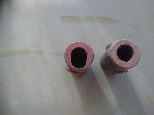

                Posted by Robin King on 06/02/2020 10:08:17:
                Why do you need to replace them?
                G'Day Robin,
                Main reason is the lathe is
                When I pulled the counter shaft assembly apart both bushed appeared tight until I pulled it apart.
                I soaked the parts in degreaser then blasted it with a 3500 psi gurni, I found this , makes me think the bearings will be just as bad.
                There are some parts the repeated soaking in degreaser and the gurni would not remove the baked on dirt and grease.
                Sorry about the rust, I had it stored on the veranda, last weekend we had our first rain in over two years.
                #451195
                Hopper
                  @hopper
                  Posted by Mark Eisen on 08/02/2020 03:23:37:
                  ….i, I found this , makes me think the bearings will be just as bad….
                  Pretty massive assumption that may well not be the case. If the headstock bearings were kept oiled they may be like new. Those countershaft bushes tend to get neglected and being a solid bushing are more lube-sensitive than rollers.
                  Inspect your old headstock bearings before spending any serious money on new ones.

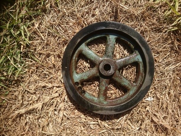

                                On an Aussie forum, I ask a couple questions about electrolysis, a couple of the bloke recommended citric acid.
                                As I had run out of washing soda, and non available in Tennant CK, I thought I would give citric acid ago, ordered some on epay, 5 days later it was here, unbelievably fast in this part of the world.
                                I have an old vice I want to restore, that I had put in the electrolysis a couple of days before, the difference is unbelievable 150 percent better, Now on the second lot of Hercus parts.
                                #454169
                                Dalboy
                                  @dalboy
                                  Mark if it is the powder form that needs water to mix then get it dry as soon as possible and primed. I have used citric acid in the past and did forget to prime afterwards
                                  #454340
                                  Mark Eisen
                                    @markeisen61287
                                    I have been blowing them off with my air compressor, then let them sit in the sun. 15 or 20 miniutes in the mid afternoon sun picked up on part of the vice and burnt my hands,secret the other bit I left till after dark.

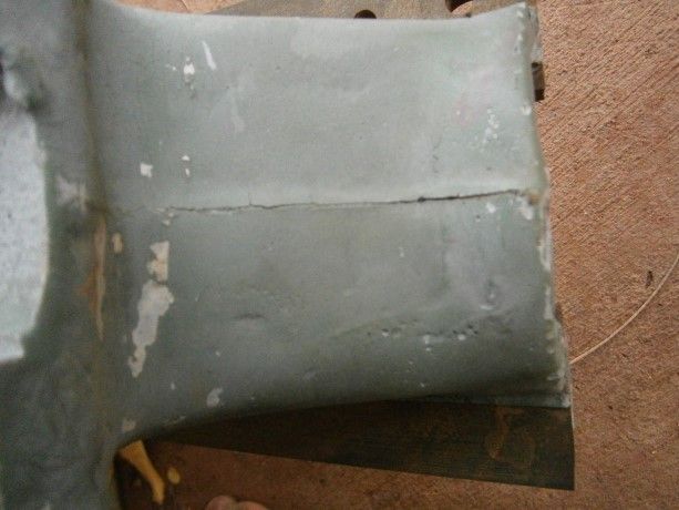

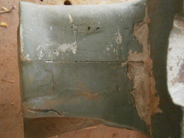

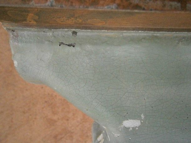

                                                  p2270497.jpgp2270498.jpgNow that I have the big parts of the bead and head stock cleaned up with citric acid, what would you do with cracks and holes in the bog?
                                                  I have a can if spray bog the will cover the small crazing cracks in the third photo, should I get a can of car panel bog to fix the damage?p2270499.jpg
                                                  #456013
                                                  Hopper
                                                    @hopper
                                                    A tube of automtive spot putty would fill those cracks. Same here in Cairns on PO delivery from Sydney. Quicker from the UK.

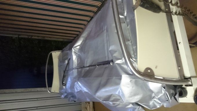

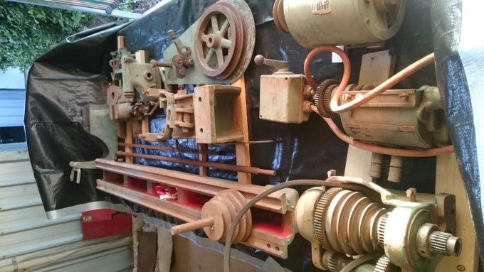

                                                      Before I had to go down south we had our first rain in two years, which made every thing go a funny colour.Had to buy a trap to cover the patient.
