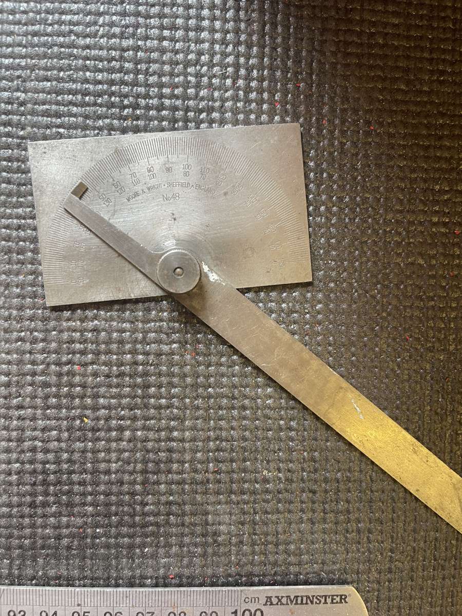

      Hi,
      Could anyone tell me how to use this tool – although it’s a protractor I’m not sure how you apply this to the piece you’d be working on – ie which side is the angle for marking – do both sides represent the two angles – with it being a vintage tool I’ve not got my head around it.
      TIAIMG_2398
      #743905
      bernard towers
        @bernardtowers37738
        its 40 deg on the lower right and 140 on the lower left.
        #743908
        triggert4
          @triggert4
          Thanks Bernard – that’s what I’d assumed but couldn’t be sure.

              #743929
              Andrew Crow
                @andrewcrow91475
                I would think if you set it to 90 degrees with an engineers square and then see where it reads 90 would give you the answer.
                #743934
                Rod Renshaw
                  @rodrenshaw28584
                  I have one of these and I have not used it much, though it is ocasionally useful.
                  Mine has a line scribed half way acrosss the “tag” on the end of the arm that crosses the degree scale and this is the fiducial line which gives the reading. It’s not very clear from your photo if the line on your protractor is present or has got abraded away from use or contact with other tools . Might be best to do as Andrew suggests and see if you can see the line or can make it more visible.
                  Rod
                  #743938
                  Rod Renshaw
                    @rodrenshaw28584
                    Just to add,
                    I think the reading on yours, in your photo, is about 45 or 135 degrees, which should give an idea of where the line should be. If you need to remark the line then Andrews idea seems best.

                      #743972
                      duncan webster 1
                        @duncanwebster1
                        You can just see the line on the photo. It might want to be made more visible.
                        #744002
                        Tony Pratt 1
                          @tonypratt1
                          The picture shows the protractor set to 45 degrees, the line is just visible.
