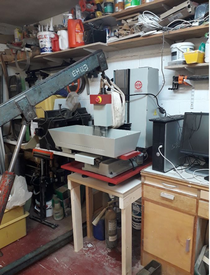

                I might be having to move this or a similar mill in the near future, at least from the ground on to a bench. I have access to an engine hoist. Assuming I choose not to part-disassemble the mill, which part or parts of the mill should the strapping be placed around for the lift? Presumably fairly high up so as not to risk the mill upending* as it is lifted, but is there a risk of damage to the mill if one weighing, say, 150-250 kg is lifted with strapping placed under the head? I mean of course damage caused by the full weight of the mill being borne temporarily by the head, not damage caused by dropping the machine.
                * I have seen a video of someone inserting steel bars right through the base of a mini-mill and advising you place the strapping round the protruding ends, but that looks to me like an invitation for the mill to tip 180 degrees unless two helpers stand either side to stabilize the mill during its ascent whilst a third works the hydraulics. Crucially, no actual lift was shown in the video.
                #448468
                  Wrapped under the head has worked OK for me a couple of times, table can be moved in/out to help with balance and if the head is kept fairly low you don't need much additional height above the machine for the crane.

                        I recently moved an SX3 on my own. I used the strop around the head method to lift it onto the base with no obvious ill effects. The table is a substantial percentage of the total weight but can be easily wound off after removing a circlip that acts as a stop, on the end of the x axis lead screw. The circlip doesn't seem substantial enough to me and I replaced it by drilling and tapping a hole in the end of the leadscrew and bolting on an over sized washer. I also found that the mill is front heavy on the base (the front feet are too far back, not on the corners where the should be) and whilst it is not unstable per se, it wouldn't take much to tip the whole thing forward, particularly if the table is wound all the way forward. As such, if you have the same base as mine and are as clumsy as me, bolt it down.

                                  The table that the mill is on looks a bit unsafe to me.
                                  Alfe
                                  #448564
                                  Emgee
                                    @emgee
                                    Posted by Alfie Peacock on 24/01/2020 10:02:47:
                                    Alfe
                                    I agree with you Alfie but Jason has previously confirmed it is up to the task.
                                    Emgee
                                    #448610
                                      Yes and almost a year later it has not landed on my toes.
