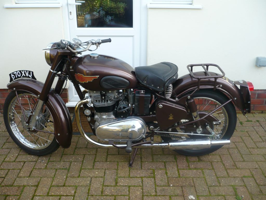

my 1954 Meteor 700cc, has been taxed and insured since first of March
That looks very nice – you don't see many early RE twins around & more is the pity . Original REs still don't appear to attract the the interest (or premium prices) of the other, more mainstream, British bikes for some reason I cannot fathom. In many areas they seem to be more advanced then the mainstream oposition, but maybe because thay were built in smaller quantities & are therefore rarer ? Surely your bike qualifies for the rolling 40 year old Road Tax & MoT exemption if re-classified as "Historic" ?

It does qualify under the forty year rule but although it costs nothing to tax it still has to be taxed, I saved this bike from the scrappy and only two things missing were the carb and the inner chain case which I made.
Well done that man!

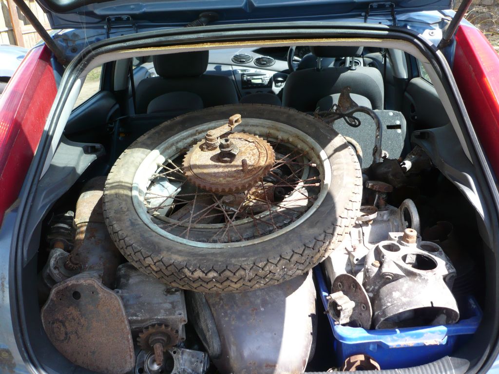

A lot of work in that rebuild Colin.
Must have been very satisfying to get it back on the road.
