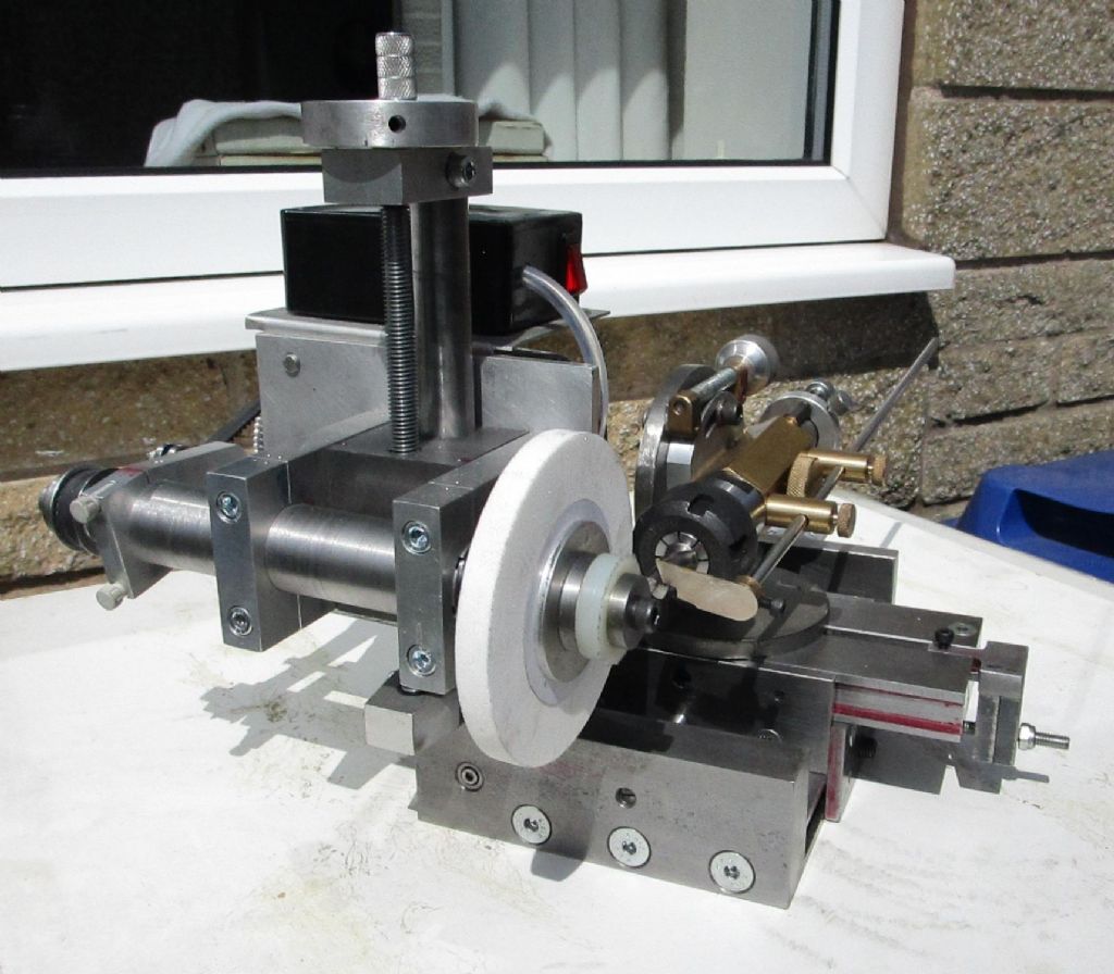

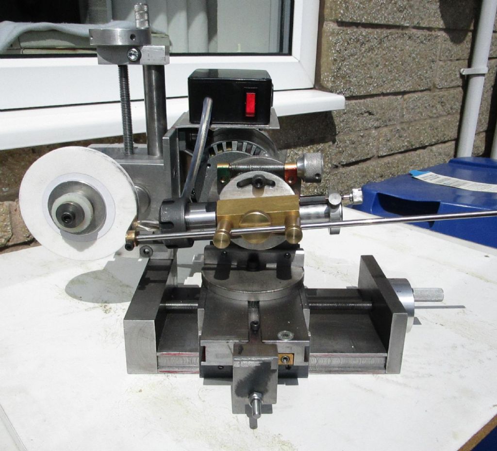

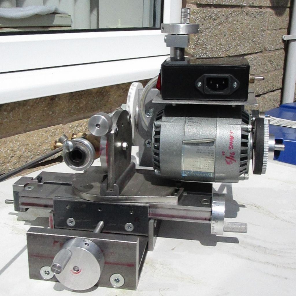

                Hi Guys,
                These are pictures of my modified Brooks TCG that I finished earlier in the year. I've ground several end mill cutters and made some specialised tools with it.
                All told its taken quite a while to build in fits and starts.
                From experience whilst using it there are one or two things that I would do differently.

                    A very nice build John. Really shows off how compact the Brooks design is. I'm impressed that you managed to fit a belt drive wheel head set up. I'd have put money on it not being possible to get a satisfactory installation as the Brooks was designed to use the wheel directly mounted on the motor shaft to make things more compact.

                                      Hi Guys,
                                      Thanks for the nice comments !
                                      Clive: The timing belt drive allows me to change the small pulley for a larger one to alter the wheel speed. As shown in the picture, the wheel runs at 5k rpm, the wheel being rated for a maximum of 5.2K. The larger pulley drops the wheel speed down to 3K.
                                      The head is moved by the threaded rod and can be raised or lowered 1.25 mm per turn of the M10 thread. Not easy to see in the picture, but the head is locked in any desired position by a split collet tightened by a thumbscrew. The complete motor head unit can be rotated 360 degrees, allowing the machine to be used as a surface grinder with a 170 mm travel. The table feeds are by M6 left and right hand threaded screws, both control knobs being calibrated in 1 thou increments.
                                      Designed to minimise size and weight, I used ball races instead of the precision ground rods that Brooks used. This nicely gets around grinding dust on the rod used as slides.
                                      This is actually one of the things that I would change, since there is no facility to lock the ways as it stands. Fitting Teflon pads and table locks would be an advantage.
