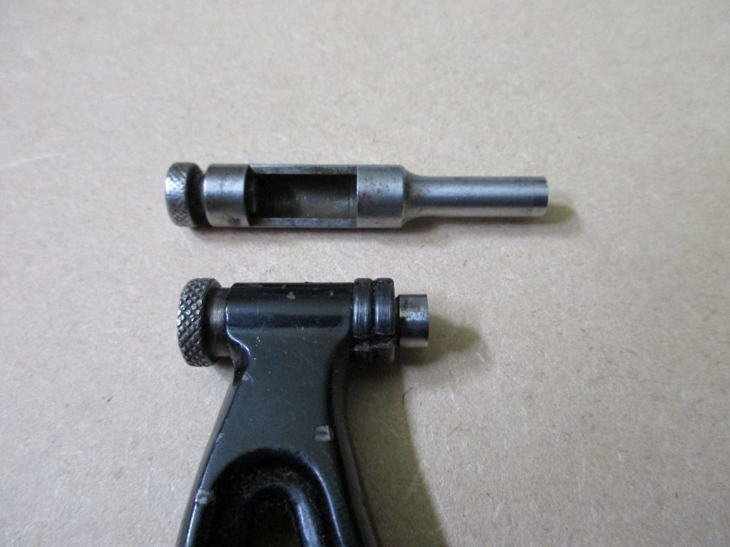

                      David George 1
                        @davidgeorge1
                        Hi Sean I have a similar anvil for a mitutoyo, it it fitts you can have it. It's been in my toolbox for at least 20 years waiting for a use. If you want it send me a PM where to post it to should you want it.
                        David

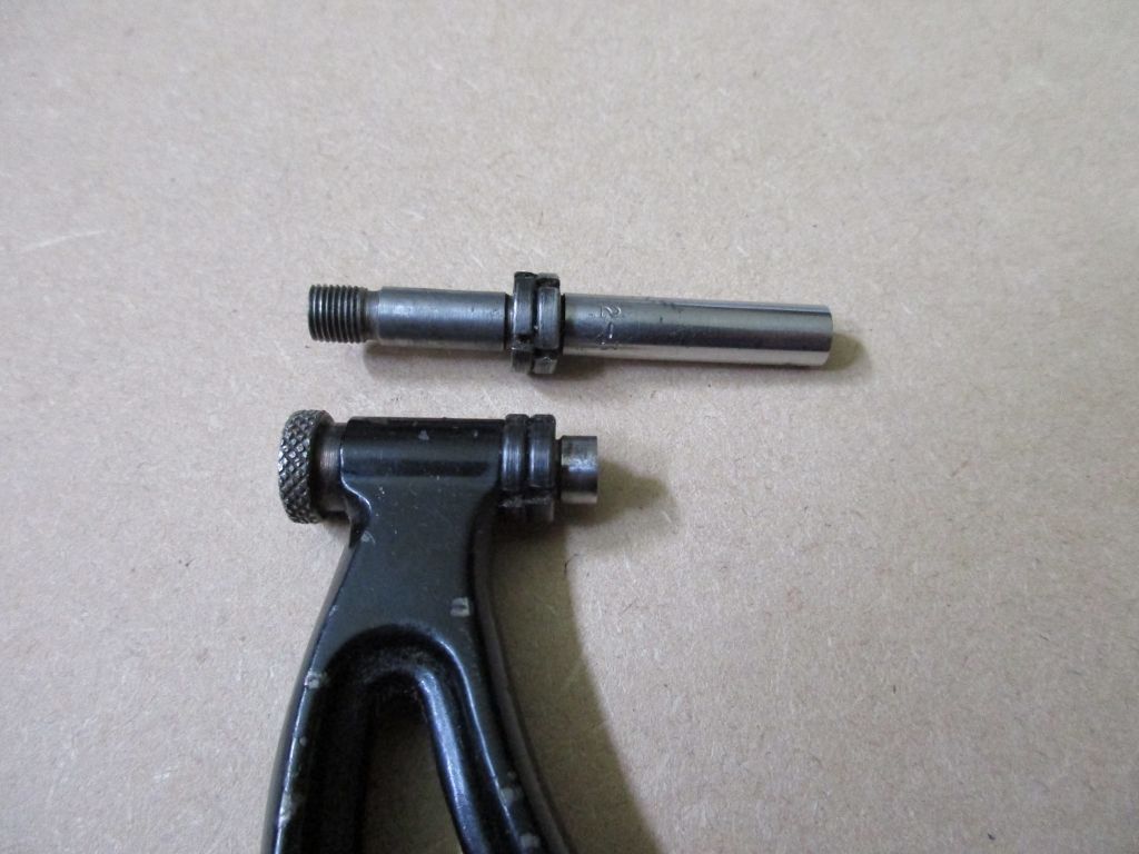

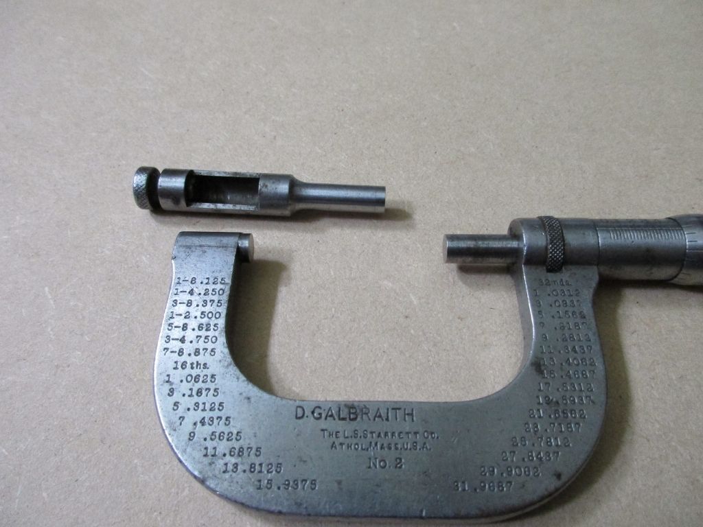

                                #300009
                                Nicholas Farr
                                  @nicholasfarr14254
                                  Hi Sean, not trying to be a party pooper or anything, but I'm thinking the anvil that David has will not be any good for your M&W one. The one David has is similar to a 0-2" Starrett one that I have, whereby it fits onto a fixed anvil micrometer.
                                  Your M&W 940 is the same style as my 0-4" Starrett one that I have, whereby the anvils are interchangeable.
                                  As you can see in the next photo, the anvil for my 0-2" one will not fit onto my 0-4" one, not only that, but it is calibrated from the fixed anvil surface of my 0-2 one, to give the correct distance to read 0-1".
                                  Regards Nick.
