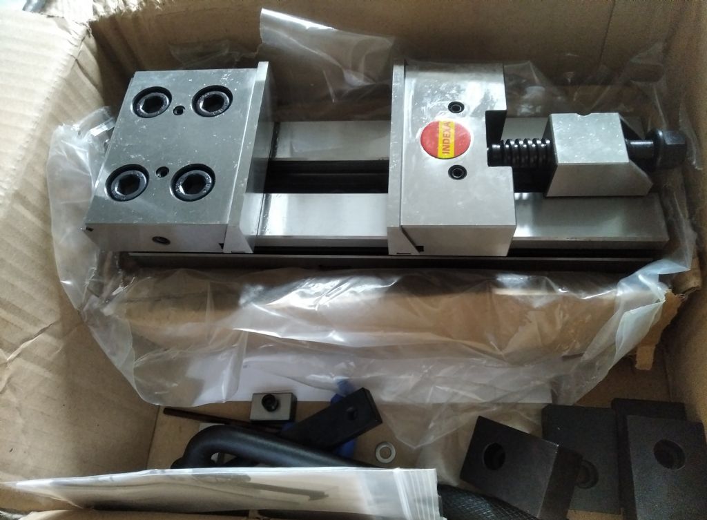

          ..tell us if it's good?
          'Square' jaws and 'flat' base?
          What're the other bits in the box?

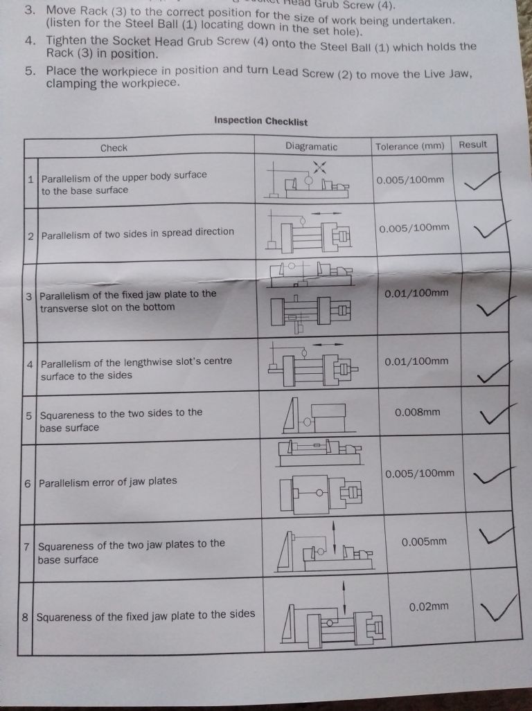

                First impressions are good, the fit and finish is excellent, I'll make my own measurements when I can, the leaflet that came with it shows it has been manually checked off, not printed check marks like someone on here had with a mill they bought.
                The contents listed also, the work stop is bit mehh, but easy enough to make something better.
