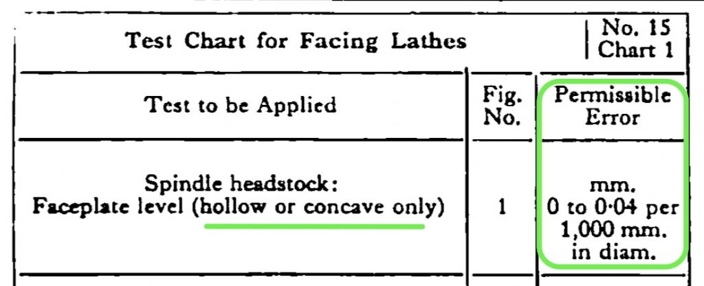

                          Various posts elsewhere on here have suggested that Myford deliberately set the machine to face very slightly concave.
                          On a used machine, half a thou sounds pretty good.
                          You may be in danger of straying into the territory where the repeatability and accuracy of the DTI comes into question.
                          Howard

                              Posted by Howard Lewis on 14/11/2020 17:09:53:
                              It’s widely accepted best-practice, Howard
                              … Hence my reference to Dr Schelsinger

                                      #507552
                                        Posted by Dr_GMJN on 14/11/2020 17:23:33:
                                        Honestly I'm not fussed about the 0.0005" convex. …
                                        That's worth investigating. Lathes are set up to cut slightly concave because it means faced work will always sit flat, which is important. If a lathe cuts even slightly concave the resulting face won't sit flat causing big trouble – rocking, stressed bolts, and inability to form seals etc. Although the error is small, it's doubled when two faces from the same lathe have to be mated. In comparison seriously concave cutting is OK.
                                        Not sure what would cause convexity. Bed twist maybe, or possibly the bed is worn near the chuck? Be excellent if it was due to the rounded tool-post allowing the cutter to turn slightly as it moves across the face, because that problem's already in hand.  (Apologies if that's someone else – past my bedtime!)
