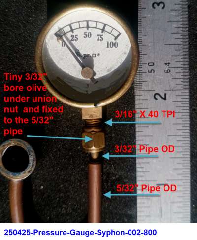

      I need to make a pressure gauge syphon for a 1″ dia pressure gauge to fit on my model 3/4″ scale Burrell traction engine.
      The photo shows one taken from my Stuart Models 504 steam boiler.
      The problem is the tiny, tiny, olive under the 3/16″ X 40 TPI union nut. How can it be made and secured to the 3/32″ pipe reduction where the union nut is?

        Swage the copper tube to fit. Paint the olive and nut with white “Tippex” away from the joint. Hold the nut away from the joint and put a ring of fine wire silver solder around the joint and heat.  Even better if you can hold the nut in some sort of vice arrangement so that it can not get up to the melting point of the silver solder. A 3/16″ x 40 tpi steel bolt would be ideal (You would have to make one!). That would take the heat away from the nut and the olive end of the joint just leaving the siphon and tail of the olive exposed to the flame.

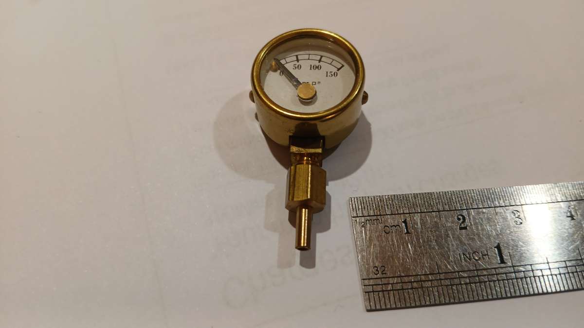

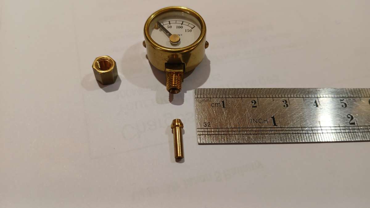

          I’d make a new nipple to suit your mismatch of pipe sizes or get some 3/32″ pipe. If making an new one I’d drill have it longer and sized to fit INSIDE the 5/32″ pipe. This is a long nipple supplied with teh gauge and intended ot fit inside the pipe and ht has a single dia hole right through so no “stop” for an inserte dpipe.

                JasonB your photo tells it all. I can see now that there is a small pipe with a union nipple already attached – could have been turned from solid brass. That is secured to the pressure gauge by the union nut. It then becomes a ‘simple’ matter to extend that pipe probably by inserting it into a larger copper pipe.
                This is possibly what Stuart Models did. The challenge is not to let solder get into the pipe bore and not melt the pressure gauge during soldering. Maybe I’ll make a CAD drawing of the arrangement.
                Anyway, your photo and explanation has answered my basic question so thank you very much.

                  Undo your nut and nipplegrom the gauge, solder then screw back on. No risk of cooking the gauge which it will. Infact you would have a job silver soldering it if attached as the gauge would draw all the heat out of the nipple.
                  Turn a new longer nipple as yours looks too short. The longer nipple not only allows sufficient length to go INSIDE the copper pipe it also allows you to keep the captive nut away from the joint as unlike a standard nipple where you can slide the nut along the pipe to keep it out the way the small hole in the nut means it can’t pass over the copper.
                  That long nipple came with the gauge as have others I have bought so it is a common option

                    Thank you JasonB again for mentioning that pressure gauges commonly come with the long nipple. My pressure gauge – 3/4″ diameter – for my 3/4″ scale Bassett Lowke Burrell model (1950 design!) has just arrived and it has a long union nipple of 3/32″ diameter, as shown in JasonB’s photo above.

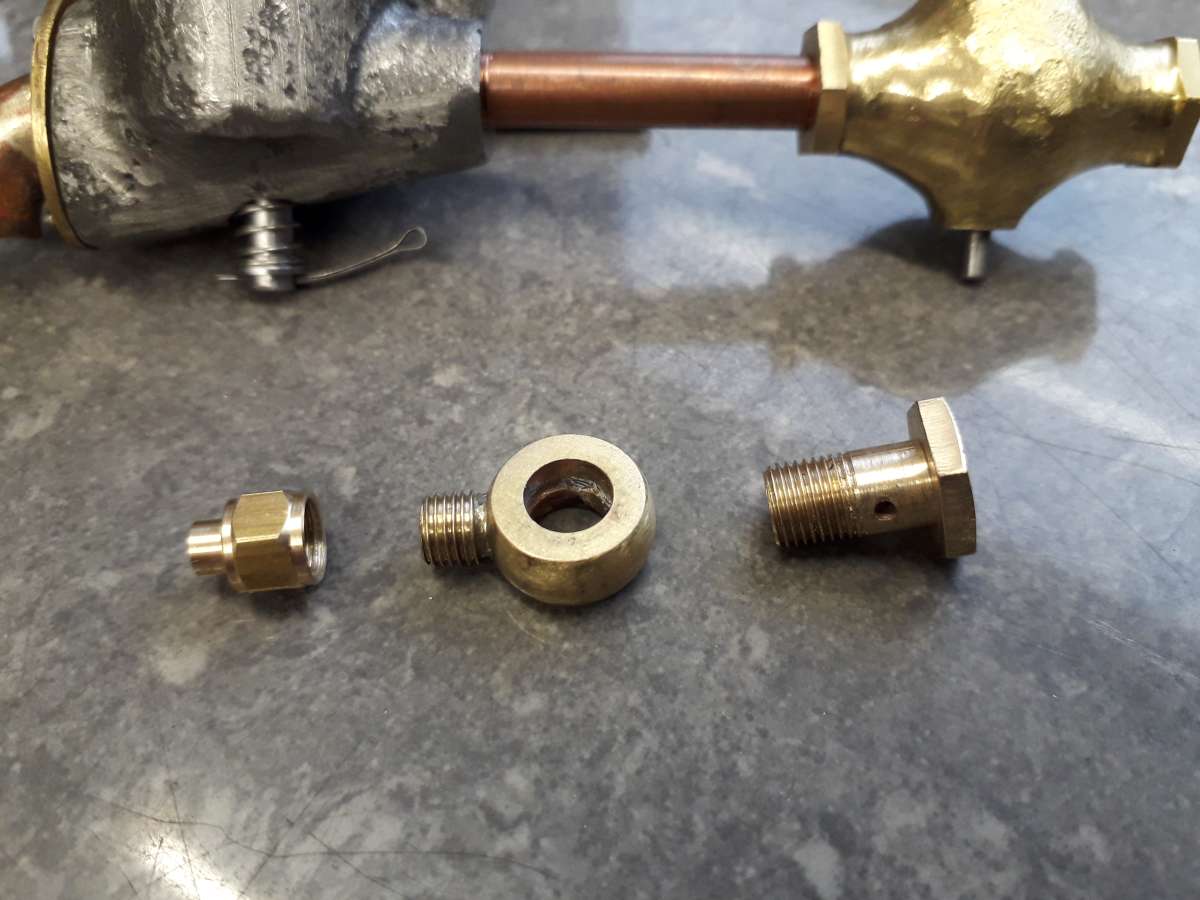

                        It is often better though a bit trickier to cut the cavity into the banjo. This means that the bolt is not weakened by the radial cut so less risk of snapping should it become a bit tight when you wnat to remove it.

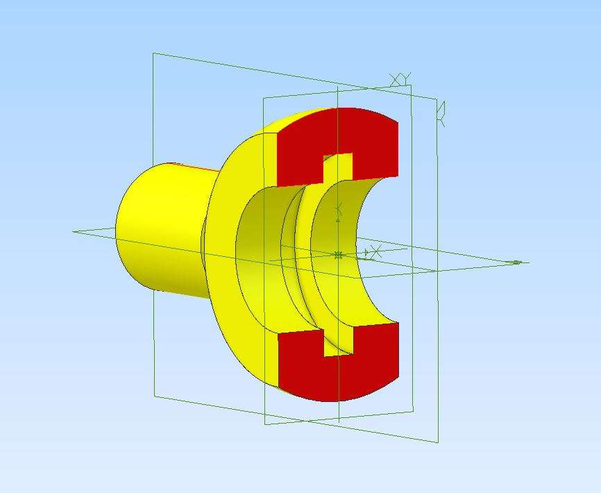

                          JasonB that’s a good point about putting a grove in the banjo body instead of a grove in the stud. Accordingly I have made a version 2 CAD drawing showing an annulus:-
                          BOILER-BUSHES-PIPE-FITTINGS-01-250428-PRESSURE-GAUGE-SYPHON-BANJO-V2-ANNULUS-200
                          As before, the full sized CAD drawings can be downloaded by clicking here.
                          Anyone following that drawing would have to make sure that the syphon pipe does not block off the annulus.
                          Your 3D CAD representation of the banjo body showing the annulus will be a great help in explaining the principle. I note you have added a nice curvature to the outside of the banjo body – nice detail.
