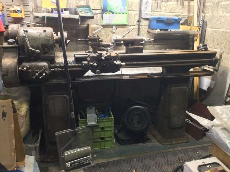

      Hey guys,
      I’ve just bought my first proper lathe, and I wonder if anyone could help me identify the exact model so I can lay my hands on a manual.
      It’s a Denham and the plate says built in 48. It looks very similar to a Junior Mk2, but with a slightly different tail (4 bolts into the leg instead of 2 and a cabinet-style leg)
      [img]https://cdn.discordapp.com/attachments/1127520729898958869/1364495513671434310/86.avif?ex=68112139&is=680fcfb9&hm=498170b77c5c5c7aaa4bc9f820c39fd3c11822a3b7bff7ad5b45861af607b948&[/img]
      [img]https://cdn.discordapp.com/attachments/1127520729898958869/1366284774318014464/WhatsApp_Image_2025-04-27_at_16.36.45_54be5bbd.jpg?ex=68110c1a&is=680fba9a&hm=abc928ee20d97ee2f7aea5b2cfdfc8b27563b6fed2b1fb54dcf7bc16f521f425&[/img]
      #795742
      Mark Easingwood
        @markeasingwood33578
        Welcome Nefarious.
        I have copied your photo here, (you can only upload jpegs, I think),
        86
        Look like it might be a long bed version of the Denham Mk11/Junior.
        See also this thread. LINK
        Mark.
        #795745
        nefarious
          @nefarious
          Aha! Thank you. I knew the Mk2 was close! I assume it’s functionally identical to the mk2?
          Sadly, I got precisely zero info with it, as it was from a garage clearance sale.
          I will have a scoot around on here for some more info, as obviously at least one other is running the same kit.
          I don’t suppose anyone might have a pdf manual kicking about?
          Oh, and thanks for the tip on posting pics!
          #795752
          Mark Easingwood
            Some info on Lathes.co.uk if you haven’t already found it.
            Mark.

              Lathes is a fantastic resource, but is it just me that thinks £48 for a PDF is a bit steep? That’s well on the way to what I paid for the lathe!
              #795858
              John Hinkley
                @johnhinkley26699
                If you want to save some money, try downloading this manual and compare it with your lathe.
                The link goes straight to a download from the archive site.
                #795862
                nefarious
                  @nefarious
                  Wow! Thank you so much!
                  A quick look says it’s pretty damn close. I’ll print it out and go and give it a mk1 eyeball!

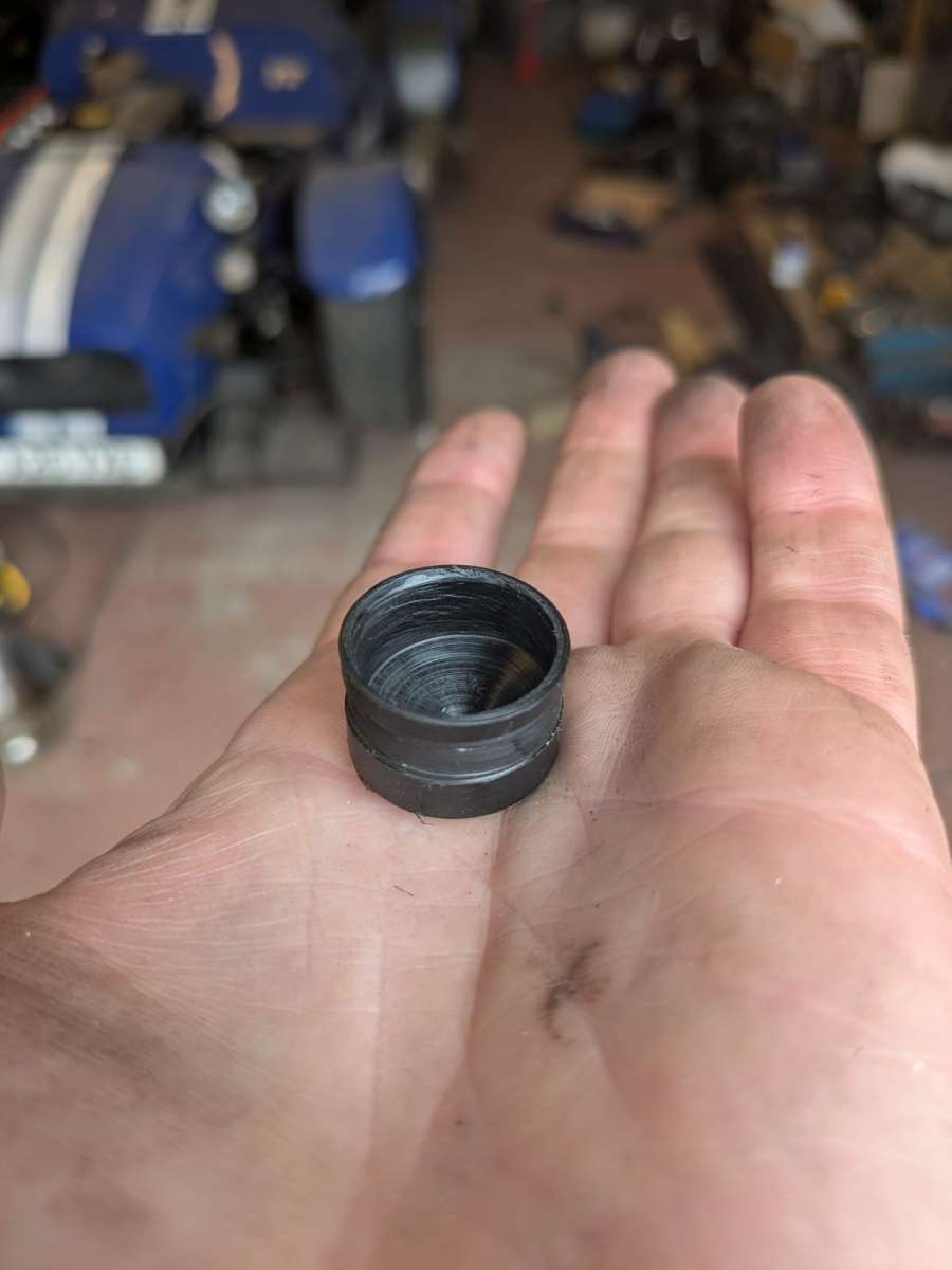

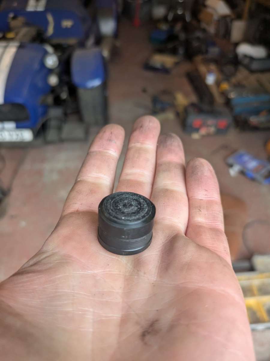

                        Well. I managed to get a tune out of itWhatsApp Image 2025-05-01 at 07.16.38_5a0bc11fWhatsApp Image 2025-05-01 at 07.16.38_78f4e710
                        #795954
                        nefarious
                          @nefarious
                          It wants a bit of cleaning, lubing and general TLC, but it works!
                          I also need to seriously up my skills, and learn the techniques properly rather than just making it up!
                          But I’m moderately happy with my first piece (well, strictly, my second piece, but we’ll brush that under the carpet). For the curious – it’s a shotgun magazine follower in acetal with a tolerance of about 2 thou, and it works a treat (much smoother than the aluminium original)!
                          My first job, once I’ve given the machine a bit more love, will be to redo it in carbon-filled PTFE for even more slipperiness 🙂
