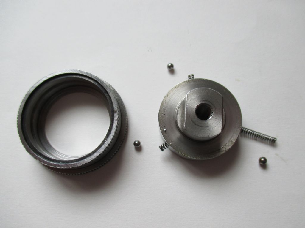

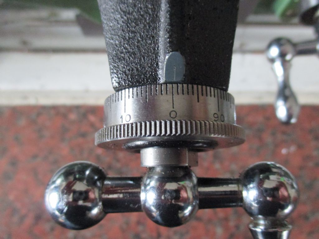

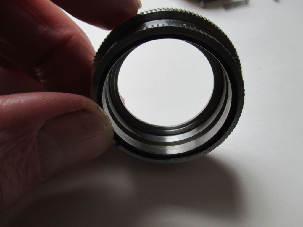

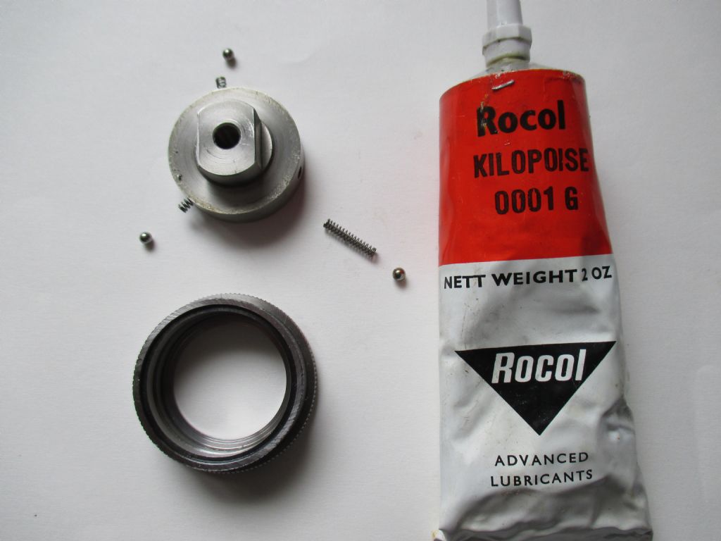

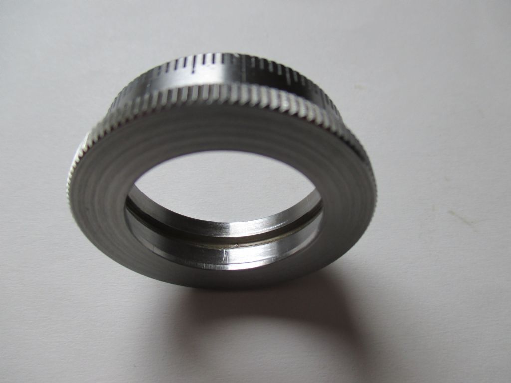

                img_0334.jpgimg_0332.jpgimg_0331.jpgimg_0327.jpgRight Clive, I pulled the dial off and took a few pictures. I used three spring loaded ball bearings as you can see, the balls run in a groove on the inside of the moveable dial. This technique gives a very smooth operation of the moveable part but may be overkill. Fitting the springs and the balls without losing some of the bits provides a great exercise in manual dexterity. If assembly is done inside a plastic bag flying ball bearings will be caught.
                I am also a fan of kilopoise grease and put a small dab of it on the internal groove.img_0326.jpg
