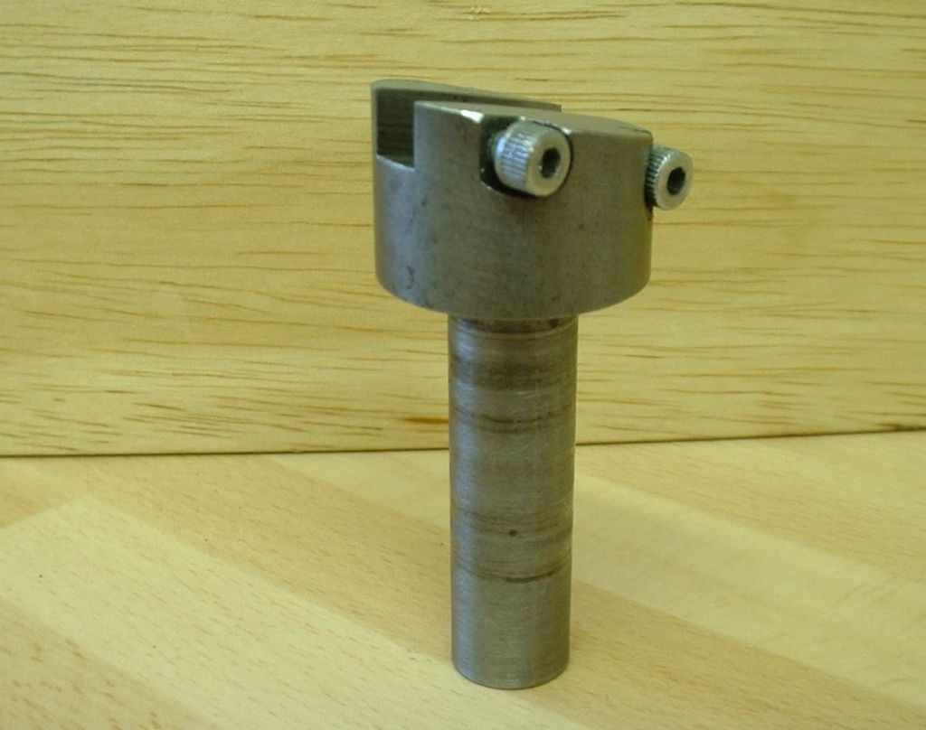

                  Easy enough to make, use a HSS knife tool as a cutter.
                  Milling with a decent diameter end mill should give results that are as good in terms of flatness, if not as good looking. If the mill is out of tram the end mill may give a stepped surface and the fly cutter a curved or angled one.
                  Edited By Neil Wyatt on 05/01/2018 17:50:45
