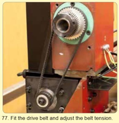

            If this is a brushless-motor equiped lathe, then I'd expect it to be set up to drive the headstock spindle directly without going through the more usual Hi/Low gears.
            As shown here, picture from Arceurotrade Mini-Lathe stripdown:

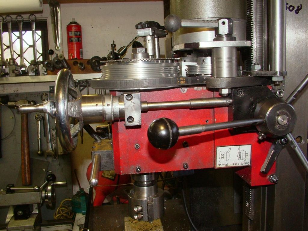

                      Hi
                      This one way to get more torque it is big bad and ugly. Functional not ornamental and works for me.
                      Spindle is on taper roller bearings
                      Eric

                                    This may seem like a silly question but does your lathe have a backgear? The photo Blowlamp posted was a Sieg with brushless motor, but I thought Amadeal sold Real Bull lathes. Warco's specification for the mini lathe with brushless motor includes steel gears fitted to headstock and if yours is the same there will be no room for a larger pulley.
                                    Brian
