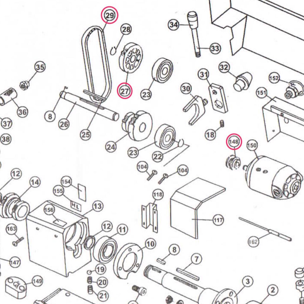

                              Posted by Michael James 5 on 26/08/2018 08:24:18:
                              Good morning Michael
                              motor pulley avtually 17 teeth/8 mm bore
                              driven belt 10mm bore/ 31 teeth
                              belt marked 1.5 x 70/ 70 cogs.
                              The bores and keyways I can do myself .
                              That's great, Michael … it confirms what I found on the Amadeal site:
                              Here's an extract from the manual that I linked ^^^
                              What Eric and myself are proposing is to replace the two timing pulleys (27) & (148) with Poly Vee.
                              … I feel quite comfortable that 3 or 4 rib J section belt would work very nicely, and you could easily get a high reduction ratio in the same space as the existing arrangement.
                              An incidental advantage is that a poly vee belt can be tensioned such that it will slip before the gears fail yes
                              Edit: useful references to the original parts
                              https://www.amadeal.co.uk/acatalog/Drive-Pulley-for-CJ18—Part-27-533.html#SID=268
                              https://www.amadeal.co.uk/acatalog/400W-motor-for-CJ18A-Mini-Lathe-AMA_SP_CJ18_150_400W.html#SID=240
                              https://www.amadeal.co.uk/acatalog/Timing-Belt-AMA_SP_CJ18_029RB.html#SID=198
                              https://www.amadeal.co.uk/acatalog/CJ18-Metal-Gears-Set-AMA_SP_CJ18_2418MGRB.html#SID=11#SID=11
                              Edited By Michael Gilligan on 26/08/2018 10:22:05

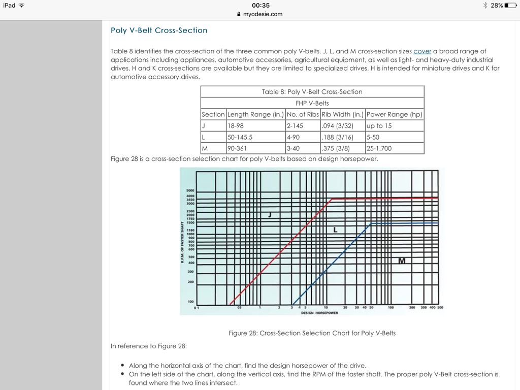

                                                    Michael G
                                                    Is there 10mm wide enough for a 3 or 4 rib belt?
                                                    I was assuming it would be a large single v..
                                                    #369185
                                                      Posted by Michael James 5 on 26/08/2018 19:32:33:
                                                      Michael G
                                                      You need to read-up on poly-vee …
                                                      That's why I emboldened the word Poly in yestersay's post.
                                                      … I will post a couple of links shortly.
                                                      https://simplybearings.co.uk/shop/Belts-Multi-Ribbed-Poly-V-Belts-J-Section-Poly-V-Belts/c4601_4791_4793/index.html?page=1
                                                      https://www.myodesie.com/wiki/index/returnEntry/id/3065
                                                      The important bit from the last link:
                                                      Edited By Michael Gilligan on 26/08/2018 20:09:06
