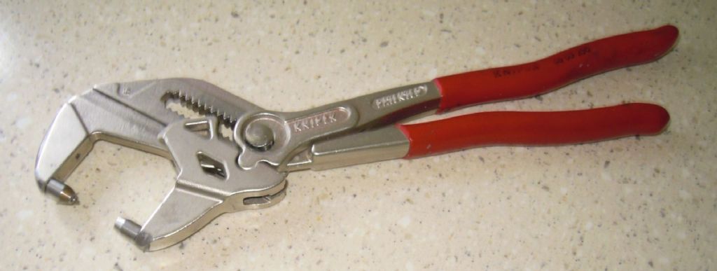

                    Johannes Grabsch
                      @johannesgrabsch91508
                      Modify a Knipex plier…
                      Works fine…
                      You need to drill the jaws, the formers are simple turning jobs. Some common sizes I did harden.
                      Johannes
