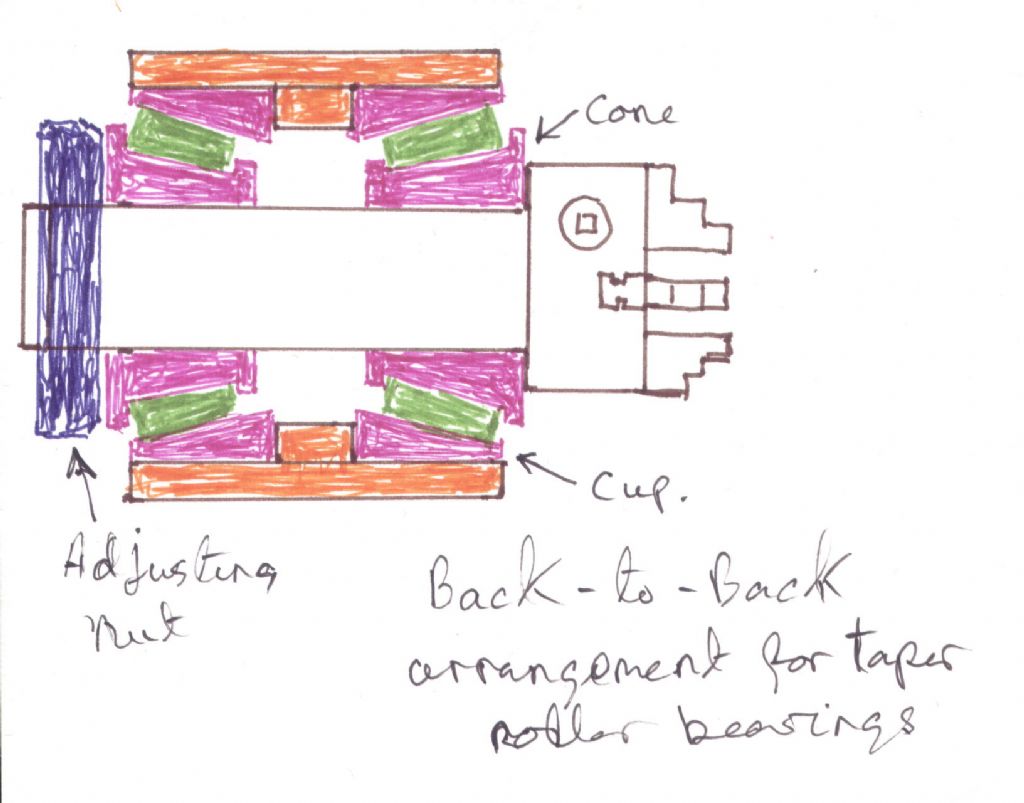

                Hi, the ball bearings as fitted will no doubt be up to the job and you should have no major trouble with them in normal use as specified by the the lathe manufacturer.
                Apart from the cost, one main differance between ball bearings and angular contact bearings, is that with angular contact bearings all freeplay can be eliminated when they are configured correctly as a slight preload can be applied. This allows a constant preloading of the bearings throughout changes in temperature without any freeplay.
                Taper Roller Bearings
                Ball bearings have to have a clearance in them to allow expansion and contraction during temperature changes and also for the lubrication medium, this is not very detectable to the feel on a new bearing but it is there. This is the main reason that the consesus makes angular contact bearings being able to produce a better finish ect.
                Regards Nick.

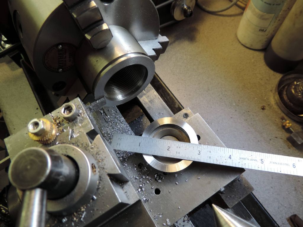

                  I am obsessive about taking my mini lathe to its limits. For example, it now has 0.5HP 3-phase variable frequency drive.
                  I changed the bearings on my mini lathe long ago. It was satisfactory before, but afterwards it was excellent.
                  I recently parted off 2" mild steel, using a 1/16" blade in a quick-change toolholder, no lubricant, just to prove it can be done. I credit the taper roller bearings with allowing me to make cuts like that.
                  I fitted angular contact bearings to my X2 mill (the taper rollers are too long for this application) and a noticeable difference in surface finish and smoothness of operation was apparent.

                      Hi Lee, there could well be a question mark in what you say, but I haven't said that I agree to the general consesus. However any freeplay will allow microscopic movments both axially and radially under varying load conditions. The angular contact bearings normally refered to are the taper roller bearings, which have more contact in thier elements and are less prone to the same distortions as ball bearings have under the same load conditions.
                      You can get angular contact ball bearings of course, but they are a differentrent ball game (excuse the pun) they are often refered to as thrust bearings which can withstand large axial loads but not so good radially. When angular contact ball bearings are used which also have a large radial load involved, a paralel roller bearing is also used on the outer side where the radial load is.
                      One has to draw thier own conclusions as to whether changing the bearings is viable or not. As I said the ball bearings sould cope within the limits of the machine and its design and the level of accuracy one is looking for. It is nearly always a matter of cost.
                      Regards Nick.
                      P.S. I will say that I would choose taper roller bearing in a lathe spindel over ball bearings, for a few reasons.
