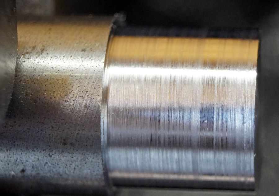

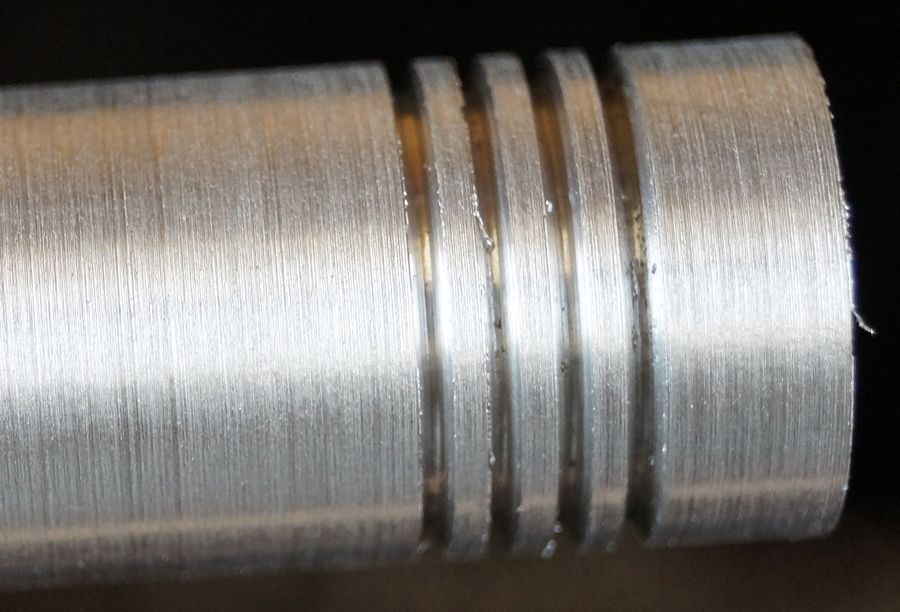

                                      #392771
                                      Ron Laden
                                        @ronladen17547
                                        A couple of pictures below of the finish I am getting, I had to enlarge the images so they may not be the best.
                                        First picture is 20mm free cutting steel, brand new carbide insert, .005" cut, speed 1600 rpm, didnt measure the feed but it was good.
                                        Second picture is 20mm 6082 alu, HSS knife tool freshly sharpened and dressed on a diamond card, 003" finishing cut, speed 800 rpm.
                                        They both appeared to cut really well but not the finish, I have just noticed that despite the different material and different cutters they look very similar.
                                        #392776
                                          Looks like something I made!
                                          Some suggestions:
                                          • the tool is too high or otherwise rubbing rather than cutting,
                                          • tool overhang is too big causing slight chatter,
                                          • swarf is failing to clear and getting trapped between the edge and the work.
                                          • lathe is vibrating – I suppose the bearings might have been damaged during installation, but your posts don't suggest you're a cack-handed brute with a big hammer! So I doubt the bearings are shot, but you might have been unlucky. Try holding an oily finger against a smooth rod while the lathe is running – you might be able to feel any untoward vibration. Also, put a mug of water on the bed and bounce a torch beam off it on to the ceiling. Then run the lathe up and down the speed range. The amount of ripple seen on the ceiling may be obviously excessive or become much worse at particular speeds. If so, may indicate a problem in the motor, drive belt, gear train, or a resonance due to a mounting problem. (Anyone know a better way of detecting vibration?)
                                          Might help to post some close-ups of the tools as well.
                                          #392777
                                            For carbide, if it is a CCMT insert you want the depth of cut to be at least 2/3 the tip radius.
                                            You can take smaller cuts with CCGT
                                            #392778
                                            David Standing 1
                                              @davidstanding1
                                              Ron
                                              Are you using the tool slide or carriage wheel to advance the cuts?
                                              I note you have been playing with the gib strips wink
                                              Try locking down whichever axis you aren't using to see what effect that has – if you are advancing with the tool slide, lock the carriage, if you can, and vice versa.
                                              Also try winding on your next depth of cut, and then locking the cross slide before advancing the cut.
                                              Just takes some of the variables out of the equation.
                                              #392780
                                              Anonymous
                                                The torn finish on the low carbon steel is exactly what I'd expect for an insert with too low a DOC and feedrate. Similarly for the 6082 I'd say tool geometry is the problem.
                                                Andrew
                                                #392860
                                                Ron Laden
                                                  @ronladen17547
                                                  Posted by Andrew Johnston on 24/01/2019 16:28:18:
                                                  Andrew
                                                  Andrew, the insert is a CCMT and I know it goes against all the theory but I have cut .005" with the same settings on low carbon steel previously and not had an issue. I will try a .020" cut, the material is 20mm, what settings do you suggest and I will give it a try.
                                                  The knife tool I used on the 6082 has 5 degree angles all round except I increased the top rake to 10 degrees for cutting aluminium, again it has not been a problem previously and always produced a good finish.
                                                  Ron
                                                  #392863
                                                    Ron if your tools have not changed and you got a good finish after changing the gears could it be something to do with the new belt/pulleys?
                                                    Are they a good fit on the shafts and running true? May also be worth playing with belt tension a little either side of where you have it now.
                                                    Having said that it does look more of a tool issue. On the steel the brighter bands are where the tool is cutting but then it is getting pushed off the work or the work is getting deflected and that gives the poor areas. The burrs on the aluminium also point to the tool not cutting well. Try a facing cut with the CCMT yo check it is on ctr height then a deeper cut along the length say 0.25mm
                                                    Edited By JasonB on 25/01/2019 08:19:30
