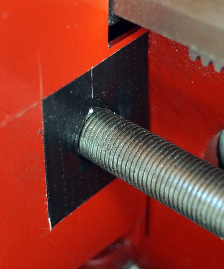

        When it happened to me, the ribbon of aluminium vapourised inside the controller with a scary blue flash and pop. Opening it up I found no obvious damage to the board : I guess I got lucky and the ribbon shorted out a capacitor and fused before causing mayhem. After removing a few bits of swarf I powered up and found everything was still working.
        My cure was simpler than Danny & Neil's. I just positioned short strips of electrical insulating tape around the hole to protect the gap.
        I also protected the saddle gears with a bit of meat pie box plastic window rather than Danny's professional perspex. Swarf in the gears doesn't do any damage but the gritty feel is annoying.  It's true – I am a dreadful bodger.

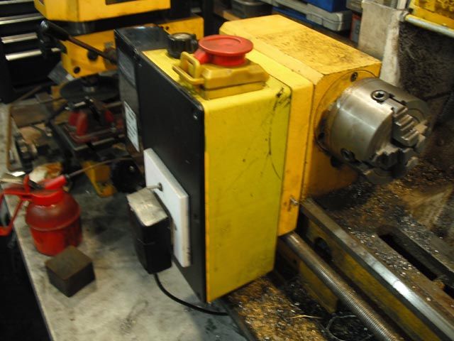

        Anthony Knights
          @anthonyknights16741
          control box.jpg                  I never liked the lead screw going through the electronics box. I fitted the speed control circuitry in a new box and mounted it on a spacer. The bigger box also allowed me enough space to use a standard potentiometer with a cam operated microswitch instead of the specified component..CL300

          Ron Laden
            @ronladen17547
            Posted by SillyOldDuffer on 18/11/2018 10:09:32:
            Dave,
            I never consider anything a bodge if it works and like you out came the roll of tape for a quick fix. I will do a Blue Peter on it though as I have some 1mm thick sticky back plastic which I can fashion a cover from.
            Ron
