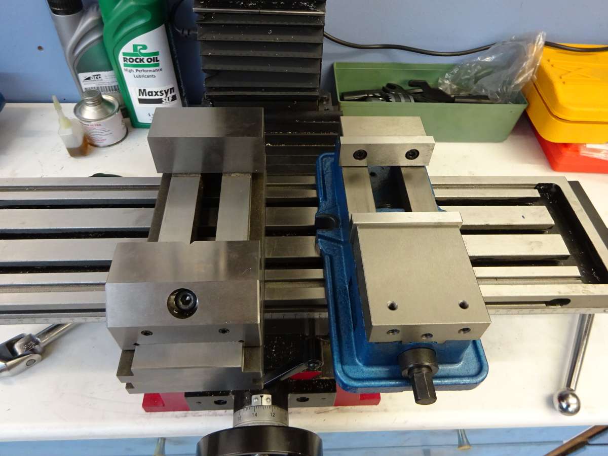

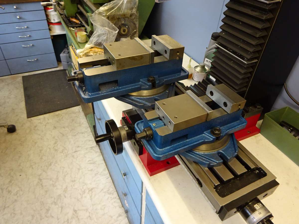

        90mm is a common size in the precision style vices and would be about right on the SX2.7, the “precision” tends to refer to the type rather than being built to a higher spec than other similarly priced vices.
        Although I have a 90mm precision one I seldom use it and tend to opt for an 80mm versatile one which is easier to operate and I find it also grips tighter than the precision which at certain openings can end up with more force pulling the moving jaw down rather than horizontally against the work. You can also configure the versatile type to hold larger work provided you don’t take too big a cut.
        Couple of photos of the 90 & 80 on the table so you can see how they compare.

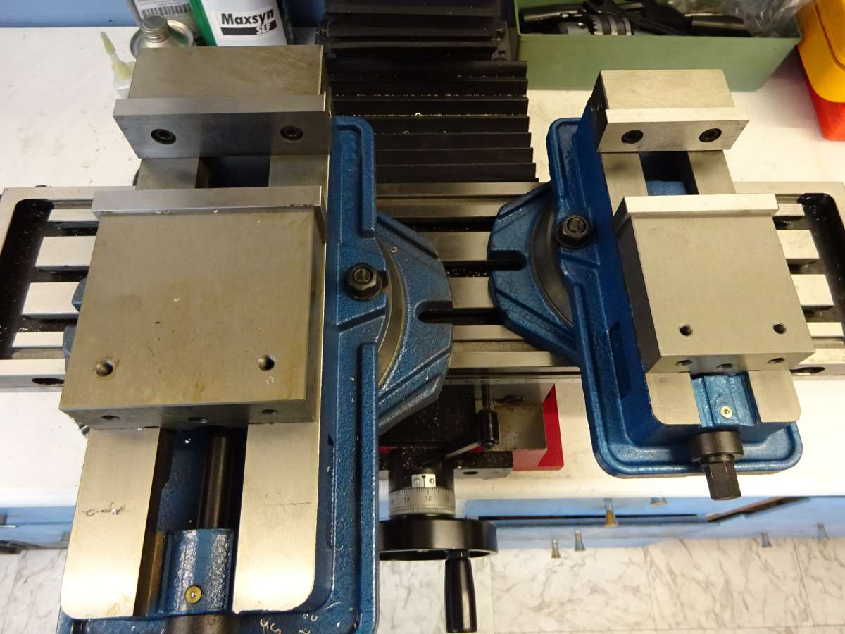

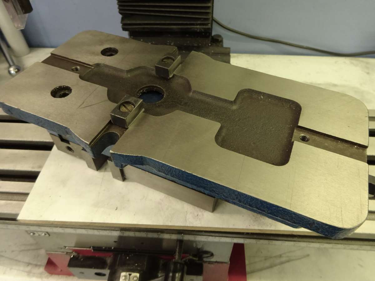

        The 100mm versatile ones are a bit large and overhang the handwheel making it hard to read and can although they will hold larger work can limit the actual amount of that work you can get a cutter to as the fixe djaw sits quite  away back behind the spindle unles syou have too mucj of teh vice hanging over th efront of the table.
        100 & 80mm together.
        DSC02245

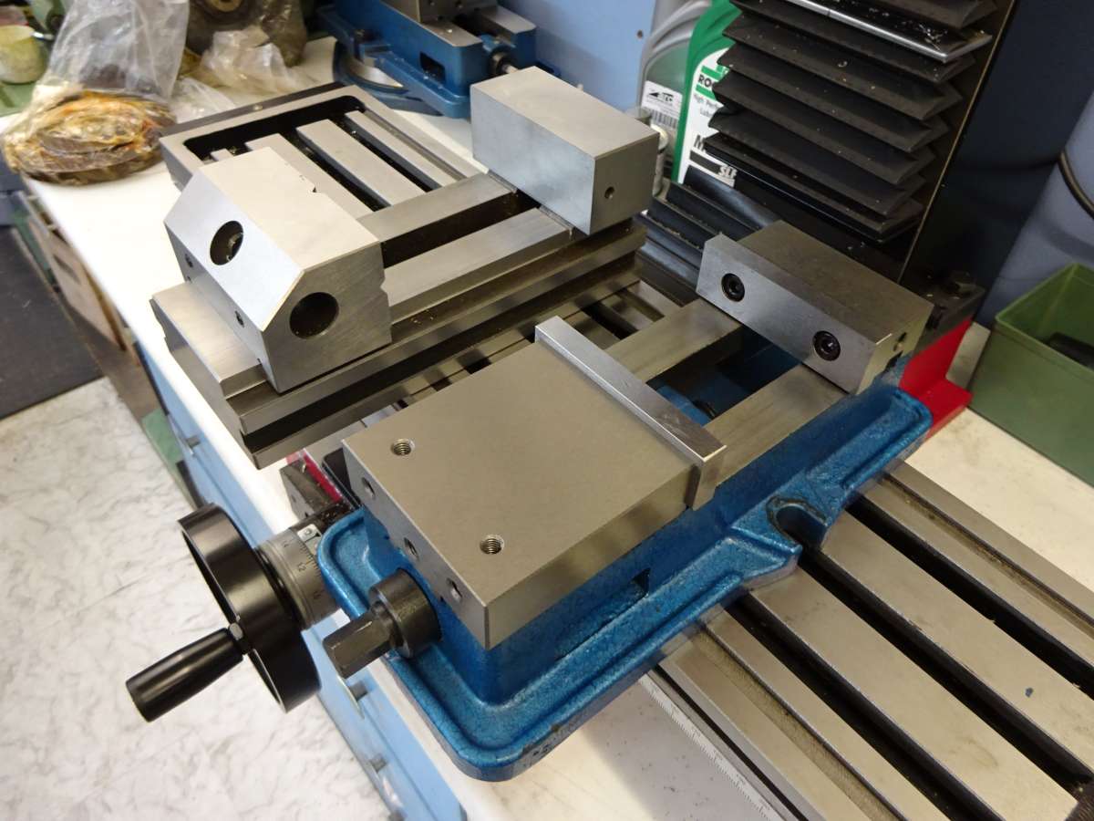

          +1 for Jason’s advice. I’ve a Warco 16B mill, similar size to the SX2.7 and the 80mm versatile vice suits my model making needs just fine. I’ve fitted tenons to the base to engage the T-slots so basic alignment is almost instant. The rotary base is normally left in the cupboard but it can be useful at times.

            I’m not sure if they all come with tenons but that is the one from ARC in the photo and it is supplied with the tennons & screws as well as having the slots for them already machined. Makes for quick set-up.
            Photo 132

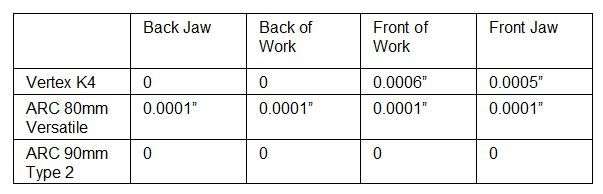

                  The one I have is from ARC Eurotrade and they don’t quote any accuracy figures so can’t really say that it lives up to something that is not specified. But I have not found it wanting as far as accuracy is conserned, bottom of the opening is parallel to the base and vertical face of jaws as square as I can measure to that. There are cheaper sources that can be a bit pot luck with what you might get but at least with a known supplier you can get any queries dealt with an dif anything ever needed to be returned it is easier than sending back to China.
                  I did do a comparison some time ago to compare jaw lift between the different vices I have, the 0.0001″ or 2.5microns lift is not worth worrying about for model engines and you can always tap a critical part down in the vice if needed (I seldom do)
