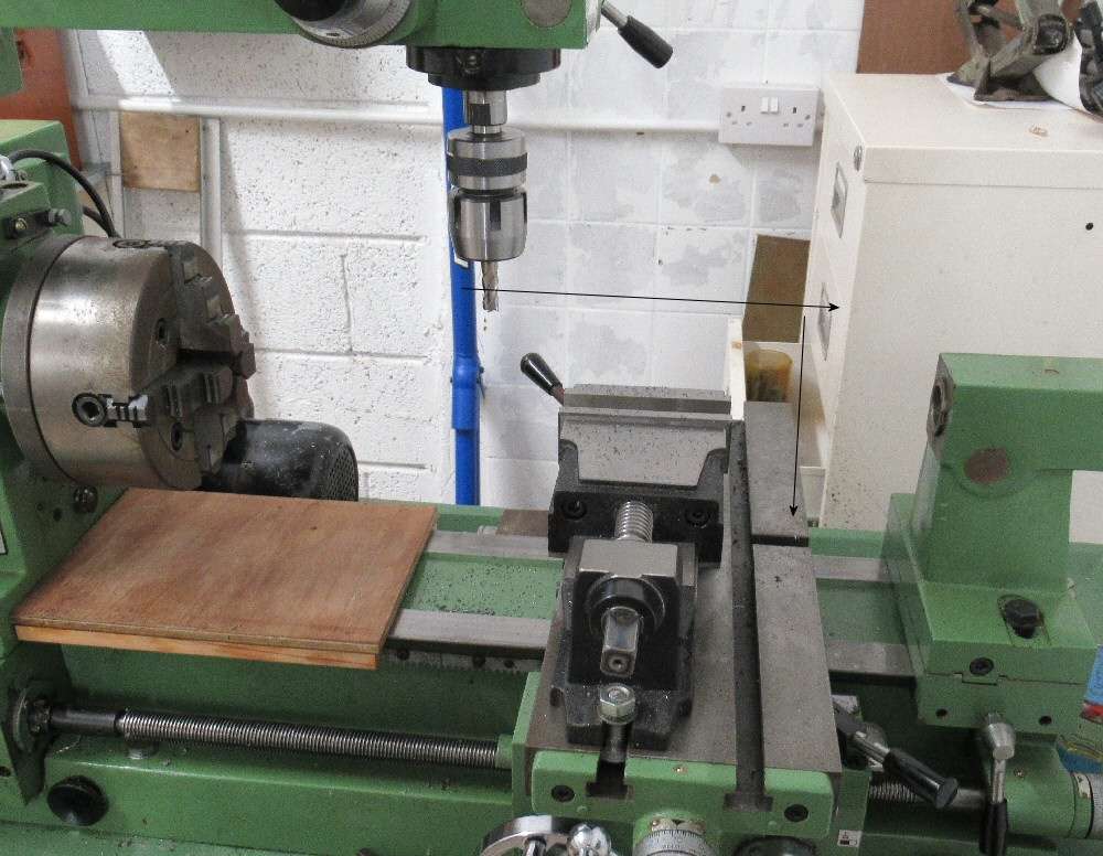

      I have access to this machine which as you can see has a milling head mounted above the cross slides. I always find is quite difficult to use due to the distance between the top of the cross slide and the cutting tool.  (150mm)  as per the image – the quill/spindle will move down 50mm from there and the whole head/gantry will move up 150mm.
      Is it normal to construct some form of platform and attach it to the  slide to reduce this height?

        Have a google for “engineers cube”

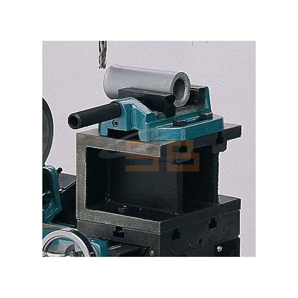

          Chester Machine tools have a similar multifunction machine & have a raisng block to overcome the issue you are having  for their machine here
          The similar Clarke CL500B (seemingly now discontinued) had something similar :
          Raising block
          You may be able to find one or the other used via the likes of Ebay.

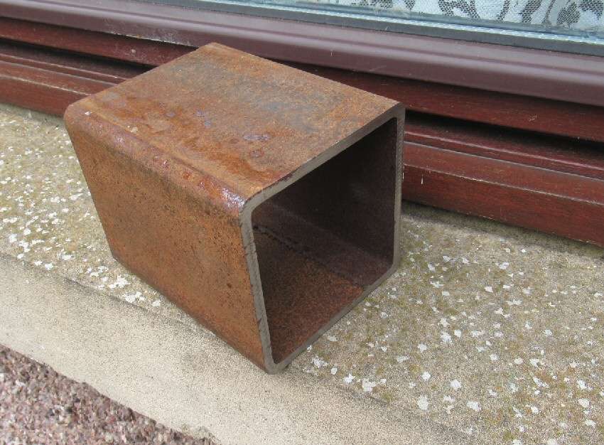

            Aye, that’s what I need, theyre no cheap and I doubt I can justify the cost for what it gets used.
            I was thinking of making something out of some 6″ square tube  (it will need to be longer than this but it will be free)
            would something like this be solid enough?  I could weld some cross members inside to stiffen it up

              Your square tube section would do the job as long as you only intend to make small cuts with care. Milling it square with the minimum of metal thickness lost will be a challenge also, but you have nothing to loose and its a cheap alternative to a cast iron cube. The top and bottom could be reinforced with some ground plates and stiffening would do no harm.
              The best solution would be a dedicated mill, but not everyone has the room or the funds for one.
