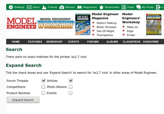

      OK, I'm baffled.surprise Are we talking about the little white box at the top of the forum home page with a "GO" button next to it? I've tried three different browsers (Firefox, Chrome and Brave) on Linux and Windows and I get "no exact matches" each time! "Forum Threads" and "Articles" are ticked. Or is "homepage search" a reference to Google's homepage? I tend to forget about that, as all my browsers are set to "blank page".
      #540044
        The google based one half way down the homepage
        #540076
        Green Techie
          @greentechie
          I've finally found it! I was going to the forums homepage, not the homepage for the whole site. I had never scrolled down the homepage of the site itself, so I hadn't seen that search box. It would be good if the search box at the top had a tick for "whole site", or even the one on the forum homepage.

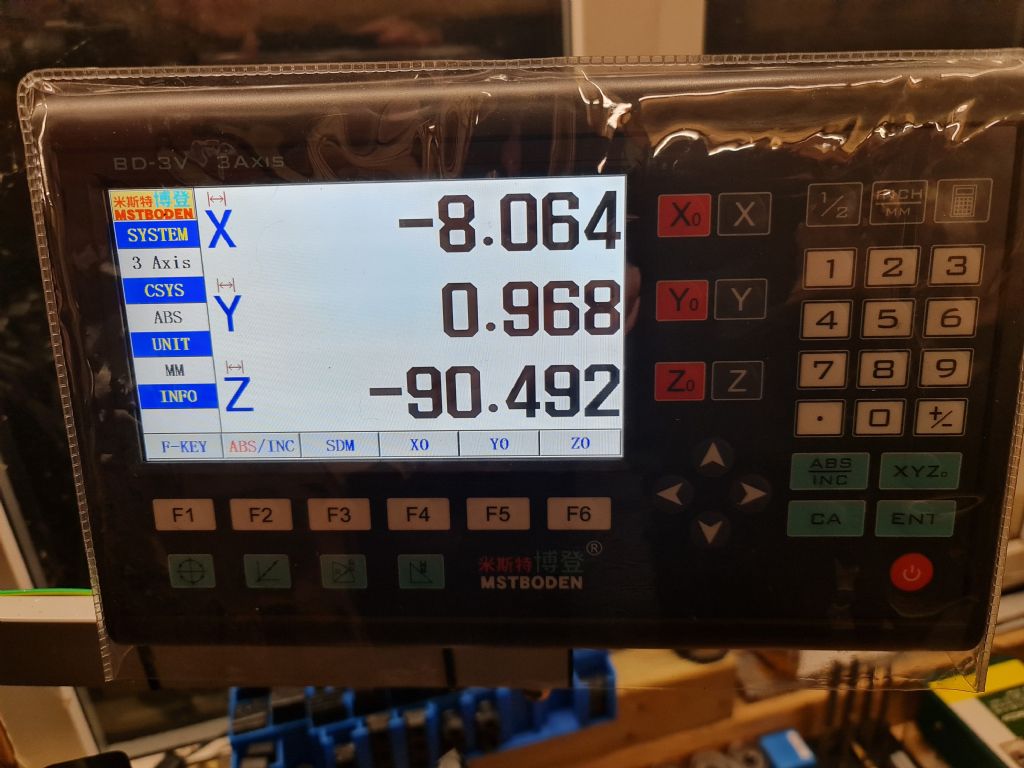

            Well the DRO arrived today, just under 2 weeks from China, it took me about 4 hours to fit it and very I'm impressed with it, need to work out a way of getting the X axis lock back in as the hole is slightly covered but shouldn't be too hard to sort out.

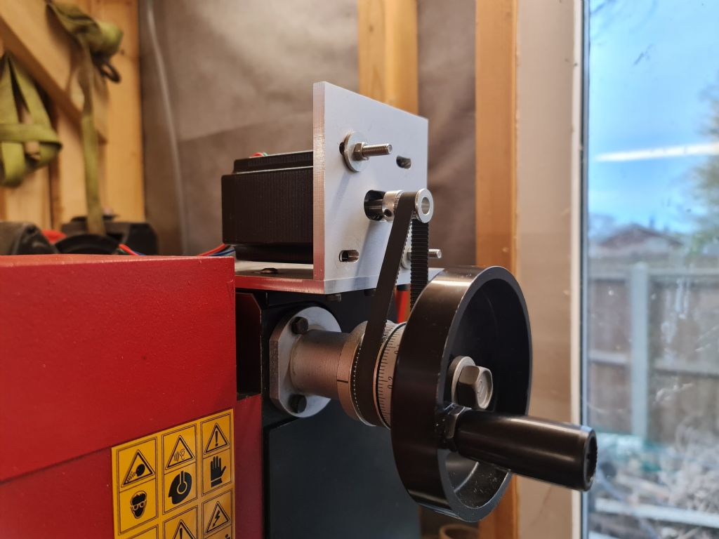

                Power feeds are going to be home brew ones, nema 23 steppers, Z will be belt driven but the X will be direct drive, no clutches, will have a small amount of drag on the wheels for manual movement but I can live with that, controls will be arduino based on a system from a YouTuber, I emailed the guy and he sent me the code for his!

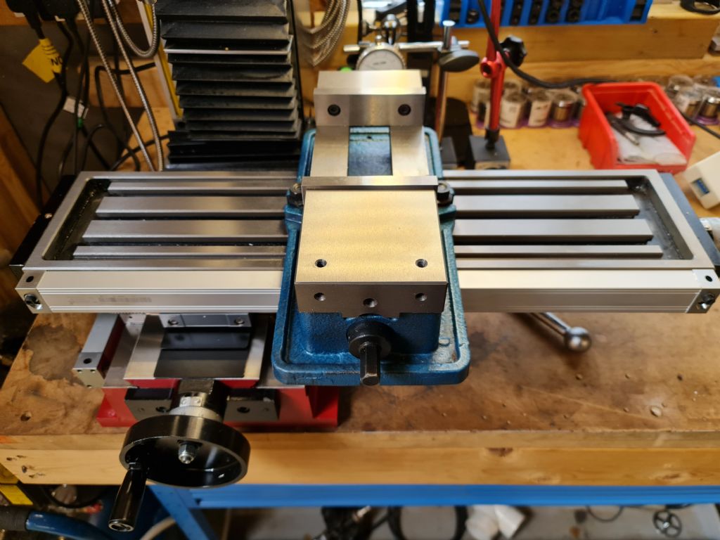

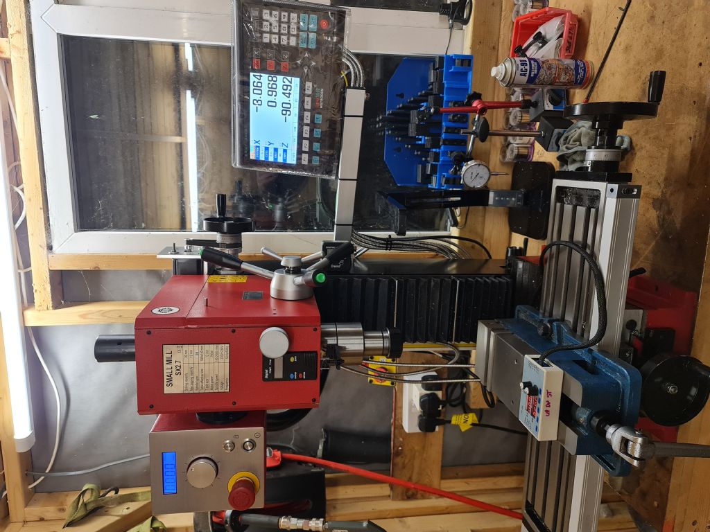

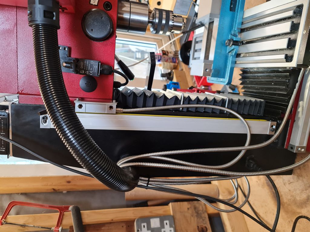

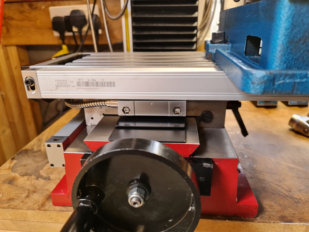

                            I finally took some pictures of the Dro today
                            My baby laugh Sorry pics on its side (and the mancave isnt finished inside yet!!)
                            Readout
                            X axis scale
                            X axis again
                            Y axis scale.
                            Z axis scale

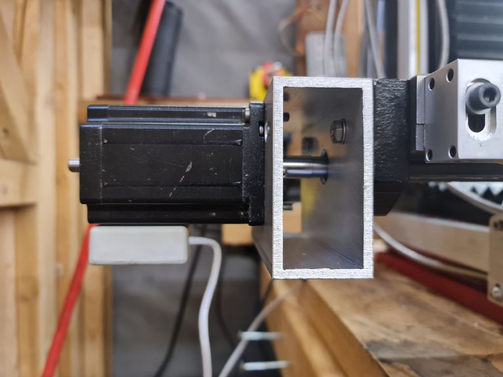

                            6 Powerlift motor
                            7 X Powerfeed motor.
                            Powerfeed drive linkage
                            Tested the feeds out and they move with no problems, only using a cheap chinese signal generator to pulse the stepper drivers to test, when its on they do not want to move by hand, but if the power is off they move fine, only a little bit of drag.
                            The Powerlift has a 4:1 reduction ratio but the Powerfeed is direct 1:1
                            Need to tidy the mounts up and fit better (shorter) bolts, that along with the proper controls I hope to get done tomorrow.

                              Good to see the photos (with any rotation). Those sizes look like a good fit.
                              The power lift isn't what I was expecting, although I now see what you meant now about some possible drag.

                                The powerlift bracket was for proof of concept, need to tidy it up, make covers etc, same for the powerfeed.

                                  With the X DRO on the front what are you going to do about mounting the stops for the X axis feed? They usually fit the slot in the front of the table so their position can be easily adjusted
                                  #542332
                                  Rob Wheatley
                                    @robwheatley66643
                                    I am thinking of mounting then in front of the scale, switches piggyback on the head and a bar with sliding stops on the scale.
                                    I did think of the scale behind the table but with the two lots of way covers it would have been a pain and I would have lost some travel.
                                    Z stop are easier, bracket on the side of the head and switches on the column.
                                    I have roller ended micro switches so the stops will be a ramp so they don't get smashed if something goes wrong, they will be wired NC to account for wire damage too.
