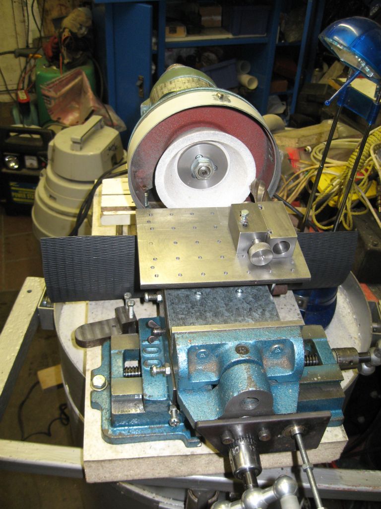

            If you only wish to re-sharpen the four end faces, there is no need to go the whole hog of a tool and cutter grinder.
            Harold Hall's book 'Tool And Cutter Sharpening' (Workshop Practice Series #38) shows how a square holder in conjunction with the simple grinding rest can be used to sharpen end mills to a very acceptable degree of sharpness. The simple grinding rest was my first major project and it is worth its weight in gold. Apart from precise lathe tools, one can sharpen screwdrivers, punches and the afore mentioned end mills.
            Definitely worth a look.
            * Danny M *

                A variation on Harold Hall's square holder is to use "Stevenson's ER25 Collet Blocks" (From Arc Euro.). I have bought a square one to sharpen my 4 flute cutters and an hexagonal one for my 6 flute cutters.
                Les.

                  I am on the case with what you suggest! When I say a toll and cutter grinder set up I meant a set up where I could grind up tools and cutters, not one of those undoubtably excellent but for me overly expensive and complex OTT set-ups.
                  In France last time I needed a small off hand grinder so I bought a cheap little 150mm dia one with the express purpose of using it solely to grind up tools when I returned to the UK. Then I read again just the other evening the Harold Hall book you mentioned "Tool and Cutter Sharpening" and saw the square holder and simple grinding rest and it those two items that are rocketing up my shed 'to do' list. So pleased to hear that you think so highly of it, justifies, if justification was needed, my decision to go down that route, and I am sure Harold will be pleased that you think so highly of it too. A materials list is being drawn up now, hope to crack on with it early next month – this month is taken!
                  Chris

                      Les – it's worth a thought, but it may be a relatively expensive way, plus I would still need a tool rest.

                        If all of your cutters are the same size than the square block holder is the best option. As I already had a set of ER25 collets I thought it was a worthwhile investment to save making a number of square and hexagonal blocks. I just adapted an old cross vice to use as a tool rest together with a modified cheap grinder. This is my lash up grinder. (Using one of Harold Hall's square blocks.)
                        Tool grinderThere is another forum thread where Neil has put a picture of the tool grinder he has made by adapting something else.
                        Les.

                              Les – for you your way makes perfect sense as you already have ER25 collets. I don't, hence for me it would be more expensive! Plus it gives me more practice in the machining operations!
