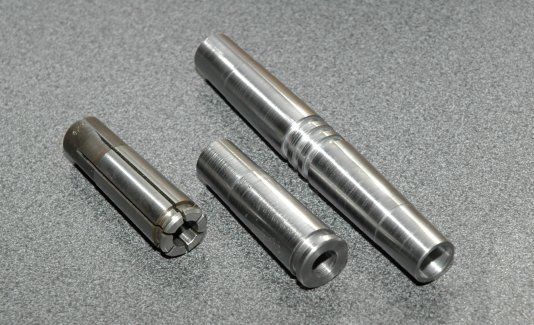

                                  Shown above is image from another website where the author is making his own Myford collets. (finished one on the left).
                                  As I said earlier, the head (or nose) of the collet is ER25, what is behind it is pure MT2.
                                  http://www.haythornthwaite.com/Collet%20Myford.htm  is the link to the author’s website.

                                    #61854
                                    Chris Crosskey
                                      @chriscrosskey26628
                                      Myford collets have nothing to do with ER…. if the nose is the same size I would suggest it is coincidental…. It’s a Morse Taper collet that uses a nose closer rather than a drawbar.
                                      I’ve got a full set of Myford collets in Imperial 32nds and metric wholes, with some 0.5mm, 64ths and an odd hex but I’d recoil from using them for milling unless I had to…. I’ve got some drawbar MT2 collets to fit 6mm and 1/4″ as it is useful for FC3’s but for the bigger stuff I use Clarkson  Autolock as I’ve been able to get a small fitting chuck to fit both my Myford and my Herbert Simplimill (for when it’s rebuilt) as well as a bigger chuck for the Herbert….
                                      chrisc

                                          Myford refer to ER collets correctly where they are indeed offering ER series colletts together with adaptors which fit the Myford “standard nose” on both the normal and larger bore lathes.
                                          To my knowledge Myford have never referred to their 2MT press in colletts as ER.
                                          I would not try to hold a milling cutter above 1/4″ dia with any hope of it staying still even when I had to use the Myford as a mill.

                                               As far as standardisation goes all  ER 25 collets are 35mm long, have a maximum diameter of 26mm and taper of 8 degrees. (Although you probably don’t want to know that!)
                                              Cheers
                                              Norman
                                              #61870
                                                The disadvantage of the Myford ER nosed collets and any MT collet for that matter is that they will only grip on the exact nominal size as they are only split at one end so trying to close them on a smaller item means it is only gripped at the end.
                                                ER collets being split at both ends keep the hole of their bore in contact with the tool as they close parallel.
                                                I also would not use the myford ER nosed collets in anything but a lathe with the correct nose thread. And if faced with having to buy a collet holder for a mill would opt for an ER one over a posilock.
                                                One other thing to watch out for is that some of the imported collet chucks about have what looks like an ER collet but is not, ARC are selling a few of these collets off at a reduced price to clear but Chester still sell the whole thing so watch out as you may pick up a chuck that you can’t get extra collets for at some time in the future.
