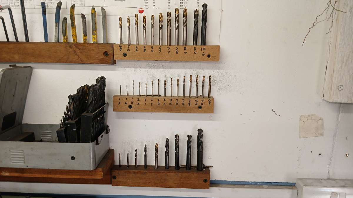

                      If you do find youself a bit vertically challenged then a few stub length drills can get you out of trouble, or simply use them rather than keep cranking the head up to get room for jobber length ones. The bonus is that if you ger split point ones such as the Dormer A002 they are rigid enough to not need a spot drill to start them of for the majority of work so also save time.
                      I have metric in 0.5mm steps plus the common tapping and reaming sizes plus a few old fractional banana ones that don’t see much use these days. I would say 90% of my drilling is done by these stub drills, jobbers just when the depth is needed or it’s an odd size.
