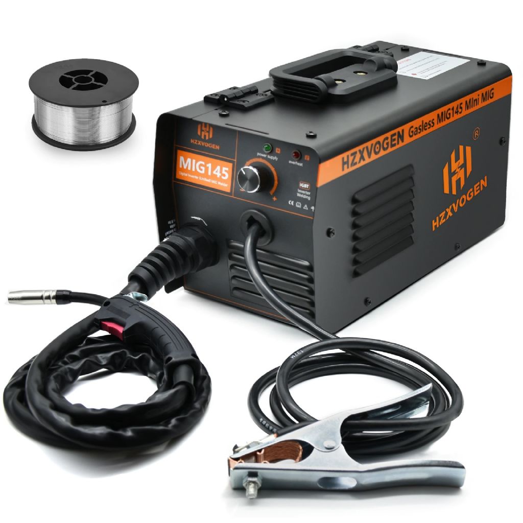

      I'm looking to buy a new welder here in Thailand, I'm nt a welder but a fitter and turner. This what I was looking at which is MMA, MIG and TIG. mig2.jpg

            Similar item on eBay in UK does not mention MMA or TIG and no accessories supplied to indicate that these are possible. Input current is stated at 22A so would not work off UK mains, don't know what Thailand power supply is like. I think the best you could expect is very light work. Doesn't do gas MIG so wire is expensive.
            Link to UK available model for comparison
            #629199
            Oldiron
              @oldiron
              Yes bought one last week fo £90 on Ebay. Bog standard gasless welder. No tig function etc. I bought it just as a gasless mig. Works ok on m/s & s/s. No frills but servisable. Needed something I could chuck in the car for odd jobs and not bother about gas bottles. Works fine off 13a plug.

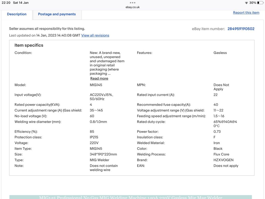

                Posted by Oldiron on 14/01/2023 10:01:12:
                Yes bought one last week fo £90 on Ebay. […] Works fine off 13a plug.
                Me being completely naive in such matters … a ‘review’ would be appreciated
                … I am bewildered by the input current requirements blush
                Are you using it on a ‘low power’ setting, or is the specification a fairy-tale ?

                  So from Journeyman's link it could be 10A to 140 or maybe 35A to 145. This is how the specs get screwed up with cut and paste and how your Thai advert mentions TIG when it clearly isn't.
                  Oldiron has clearly used his so we know the design works.
                  Just make sure you can get the copper tips for the gun where you are as it doesn't have a Euro plug in gun. You will get a burn-back that wont come out of the tip at some time.
                  Don't buy the cheapest wire you can find it won't work very well.

                    It depends. Gassless 'mig' of that size has limited use-cases.
                    If you want to weld biggish bits of metal together then Stick is cheap and works on dirty metal.
                    Gas MIG … proper welding gas really makes life a lot easier. If you want nice looking welds then try and get gas. Co2 works, but proper welding gas is much nicer. That can be a problem to source. MIG beats stick on thinner material.
                    TIG – stick or MIG welders pressed into service as a TIG will be much more difficult to use than a proper TIG welder (which the example is not). Not a nice introduction for beginners. A beginner friendly TIG will have lots of knobs on it to control parameters.

                      I'm not a pro, more an enthusiastic amateur
                      Gasless mig is fine for thinner work up to 140A 8mm
                      Over 140A – 10mm plus I use arc/MMA because stick penetrates solid steel far better
                      It's very good for sheet work, get a more expensive unit if you're doing quite a lot of work, £200+ a pop units have a far better more stable arc for tack welding thin work
                      If you find yourself doing a lot of work and enjoying it you will quickly move up from a base unit to a better mid range intermediate unit
                      Get a decent mask like a parweld trucolour
                      Gasless mig produces a harder more brittle weld which is harder to machine than softer MMA welds but it grinds down fine

                        Only a dial for setting power which increases or decreases the wire feed to suit. So easy for beginners.
                        The gun has the standard replacable euro tip holder/spring assembly so parts readily available. I have tried spares I hold for my big mig welder & they fit ok.
                        It is ideal for little jobs & tinwork. I have tried 6mm plate & 1mm sheet. The sheet was a doddle but the thicker plate was a bit slower going. The 140amp might be a bit on the hopeful side. But slowly slowly catchee monkey.
                        Was actually surprised by the lack of "spatter" around the weld.
                        I welded a 13mm bandsaw blade today and that appears to be fine. Need to run it for a while to test.
                        Also welded a couple of pieces of galvanized sheet. A bit smokey but it did the job although I only did a 50mm run.
                        Looking for some gasless Ali wire to try.  BTW using 0.8 wire.

                              Probably a combination of dubious specifications, ruuning at lower current / duty cycle and the fact that a "13A" outlet, fuse and lead will carry considerably more than 13 amps for a short period.
                              Electrical specifications, quality and safety compliance of this sort of thing from China are very suspect in my opinion.

                                  Hi well looking at the ratings plate in the second photo of Journeyman's link, it looks OK to me to use on a domestic 13 A plug top, albeit not on a continuous duty cycle at the highest setting maybe. Not that I'm a fan of gassless welders, had one years ago when that was all I could afford, and was only just a little bit better than useless.

                                            Posted by Nicholas Farr on 14/01/2023 15:12:55:
                                            Hi well looking at the ratings plate in the second photo of Journeyman's link, it looks OK to me to use on a domestic 13 A plug top […]
                                            I must have been confused by the numbers in the description :
                                            Rated input current (A): 22
                                            Recommended fuse capacity(A): 40
                                            … I plead ignorance blush … grateful if you could educate me.

                                              Hi MichaelG, open Journeyman's link and then advance the right hand arrow ( > ) in the picture to select the next view and you will see the front view top left and the back view bottom right, place your cursor over the space under the front view and to the left of the back view where is has HBM 145.
                                              Hope I've explained it to your requirements.

                                                But what of the descriptive text ?

                                                  Hi MichaelG, well seeing the the same thing is printed on the top right hand corner of the back view and Oldiron says the one he has works fine off a 13 A plug, I took it that the descriptive text is incorrect. I have seen incorrect descriptive text on somethings that I have bought which were ordered on line, even from the likes of Currys/PC World.
                                                  Regards Nick.

                                                    MichaelG, No mention of a fuse rating in my instruction book. The 13a UK plug came with a 13a fuse fitted.

                                                      Thanks, Nick
                                                      I’m not impressed, but your logic seems sound enough.
                                                      I shouldn’t have bothered asking about it. [ it’s an ebay listing after all ]
                                                      Edit: __ and thanks Oldiron
                                                      Trouble was … I read the text; and when I saw your first comment that prompted my dumb question.
