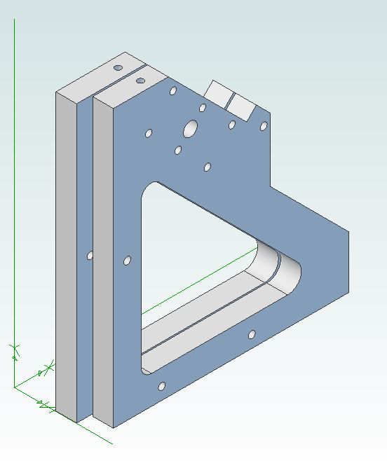

      Nice to see another Middleton engine, I still class myself as a beginner so it is an ideal engine to have a go at. The last one I built was the Middleton V4, a nice lump of an engine.
      Don't know if anyone has spotted the deliberate mistake yet!!!
      Page 286 Engine Frames (Fig 6)
      "I started with four pieces of 5 X 41/4 inches 3/8 inch thick aluminium plate"
      Oh! No! you didn't sad
      page 288 shows them to be 5 X 41/2 inches
      Guess what I cut mine to!!! angry
      What a numpty!

            Howi there is a slight revision to those frame drawings should be in the next issue 4569 but if you are eager to get on let me know and I'll upload the revised drawing. If you ask really nicely I can do a special to suit your small bits of ali.
            Since I spotted that I have cast an eye over the rest and made a few more corrections for Diane so rest should be OK though I have not read the text.

              That would be much appreciated, I have not been in the workshop for a few months, due to lots of jobs around the house. I thought this would be the ideal project to get my interest stimulated again.
              It is a nice looking engine and all bar stock apart from the flywheel, although I have fabricated flywheels, you can't beat a bit of cast iron.
              I have cut and squared up 4 pieces of aluminium to my wrong dimensions (ho hum!) and only noticed my mistake when I started to mark up the first piece. Thought I was going bonkers, it was getting late so thought, put it down and draw it up on graph paper and try and see what I was doing wrong – that's when i noticed my boo boo.
              I can probably attach a 1/4 inch piece at the short end somehow on all 4 pieces then mark out again.
              That will teach me to go racing ahead without my thinking cap on. embarrassed

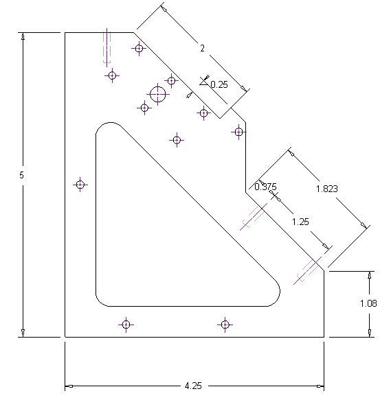

                The main issue with the frame drawing was that the hole for the valve rocker arm was in the wrong place and the 7/8" height of the lower corner was wrong. I have only shown the wrong items, rest is as per the mag
                Revised drawing
                Howi I think you will mave to see if you can add a bit on or move the cylinder mounting hole along a bit as it comes right on the edge, 1/8" further up should do it. but this shows the revised height of the end for a 4.25" frame
                Howi's drawing

                    Another option would be to increase the central gap to 1" as below, or you could go 3/4" which would give you a bit more where the cylinder mounts.

                        Have gone with shaving 1/8inch off either side as the best compromise.
                        Just got to sneek into the workshop now.
                        #315012
                          Sneak this in with you, it's got the 1/8" off either side

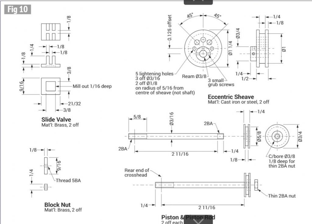

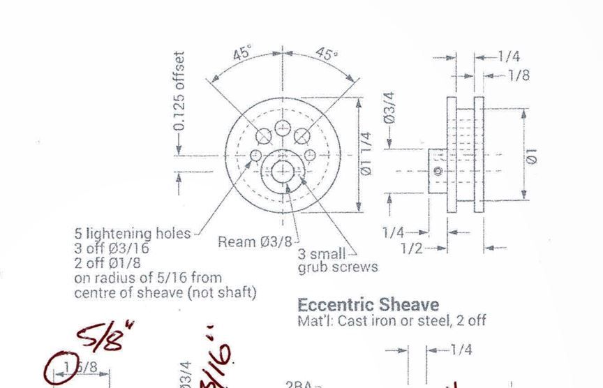

                              I have been cutting metal for the Middleton V Twin for more years than i want to own up to and have just reached the stage where I would like to make the eccentric sheave and discover that I do not have the drawing for it
                              Can any-one help me out please?
                              Michael

                                Here you go

                                  I cannot see or print the whole page
                                  Michael
                                  #613690
                                    this is the hole of fig10, click and it should come up larger
