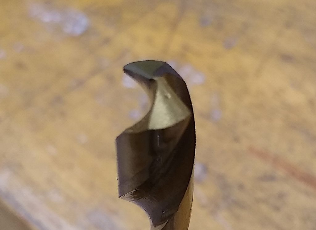

                              Rik Shaw
                                @rikshaw
                                My local LIDL had piles of these drills in stock this afternoon so I conveniently forgot the lessons learnt in the past when buying far eastern tools (drills in particular) and "treated" myself to a box. Stupid, stupid stupid angry
                                I checked the quality when I got home. Even one of the two 10mm jobs had been ground so far of centre that it will only be usable on steel / brass after a regrind. I'll leave you to imagine the general standard of the rest in the box.
                                There will be those who say I should have checked the contents before buying and I would have done but the lids to all the boxes were secured with nylon cable ties.

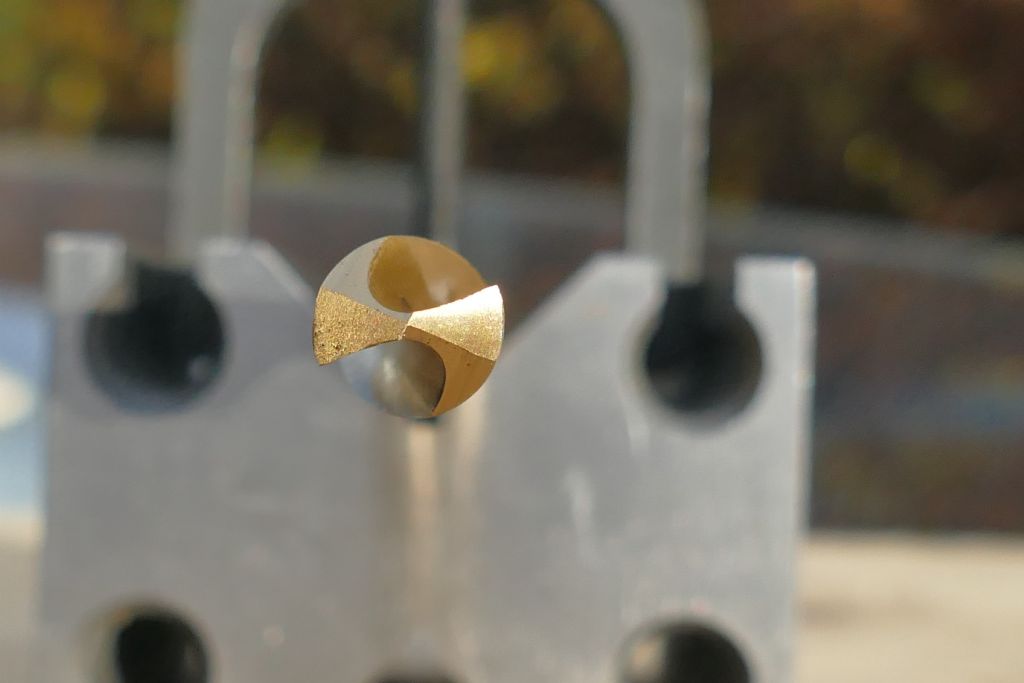

                                      Journeyman mentioned the grind being four faceted. Maybe he got a different batch, but mine were not four faceted, more point thinned I think:
                                      #577609

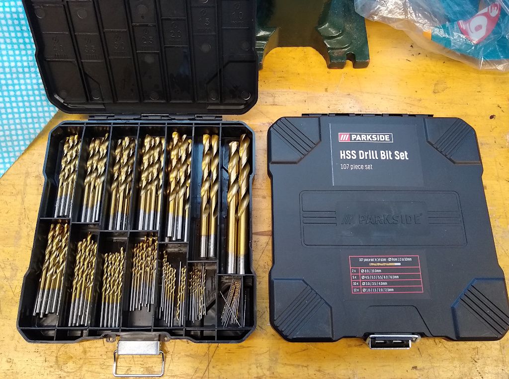

                                      Journeyman
                                        @journeyman
                                        I think mine are 4-facet (split point) not a good photo but:-
                                        This is what I bought.

                                          I bought a set and they look pretty good, same tip grind as Journeyman's.

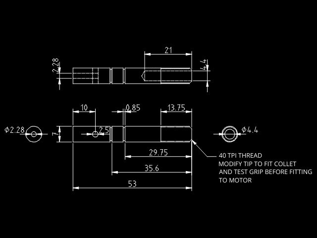

                                          An unfortunate design flaw (which they share with Dremels) is that the plunger to lock the spindle for tool change is carefully placed where your index finger tends to fall whilst in use, resulting in a high-pitched crunch, and eventual failure to lock the spindle as the locking holes get mashed up.
                                          However, a replacement is simple to make (I used leaded EN1A, the original was brass):
                                          You need to remove the old spindle from the motor by machining it away – its pressed on too tightly to pull off without damaging the motor. The motor shaft measures 2.28 mm as above , but I drilled the hole 2.3 mm and loctited it together.
                                          To avoid the same thing happening again, I dispensed with the built-in locking plunger, and used a separate knurl-headed pin. The slight extra inconvenience is worth it to my mind, and if you mislay the pin, you can always use the shank of a 2.5 mm drill – it should be no problem finding one, there are 12 of them in that box of Lidl drills…

                                            Can you share a photo Rik?

                                              #577792

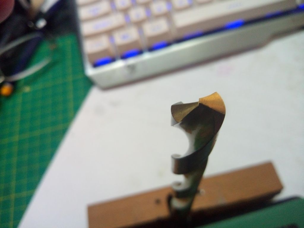

                                                I bought a box of the drills today and they look ok for general use and sort of split point from 5mm upwards. You do get a lot of drills for the money. Unfortunately, both of the only two remaining boxes had the metal clasp missing, so I will have to be careful with the box.
