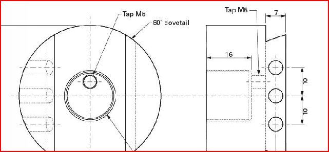

      I've just got round to making this based upon the free plan and having made almost all of the parts I'm struggling to know where to position the threaded hole for the leadscrew nut in the boring head body? There are no dimensions on the drawing to indicate its position.
      Thinking about it, it looks as if clockwise rotation of the RH threaded leadscrew should advance the cut which would ideally have the nut on the far-side of centre to give maximum slide travel but the diagrams appear to show it on the closer side of centre which has me confused further.
      Any guidance would be gratefully received.

          Ok, so I suppose that no one else has made one yet? frown
          I decided to go back to first principles and check the operation and position of the boring bar holes and indeed I'm now convinced that the M5 threaded hole for the leadscrew nut should be on the far-side of centre at about 30mm from the face where the leadscrew dial fits.
          From my reading, the drawings are in conflict with that. The exploded view of the head in Fig. 1 shows the hole on the nearer-side (lower in this case) and Fig. 3 seems to show both the dovetails and the threaded hole to accept the arbor in solid lines rather than dotted as if they were on the front face. The side view shows the M5 set-screw holes in a consistent manner with Fig 1. I now think that this is wrong.
          I've now finished the main boring head and although I haven't yet bored the holes to accept the boring bars, the leadscrew and dovetails do work well and seem to give the correct range of adjustment.
          I hope this proves useful to someone.

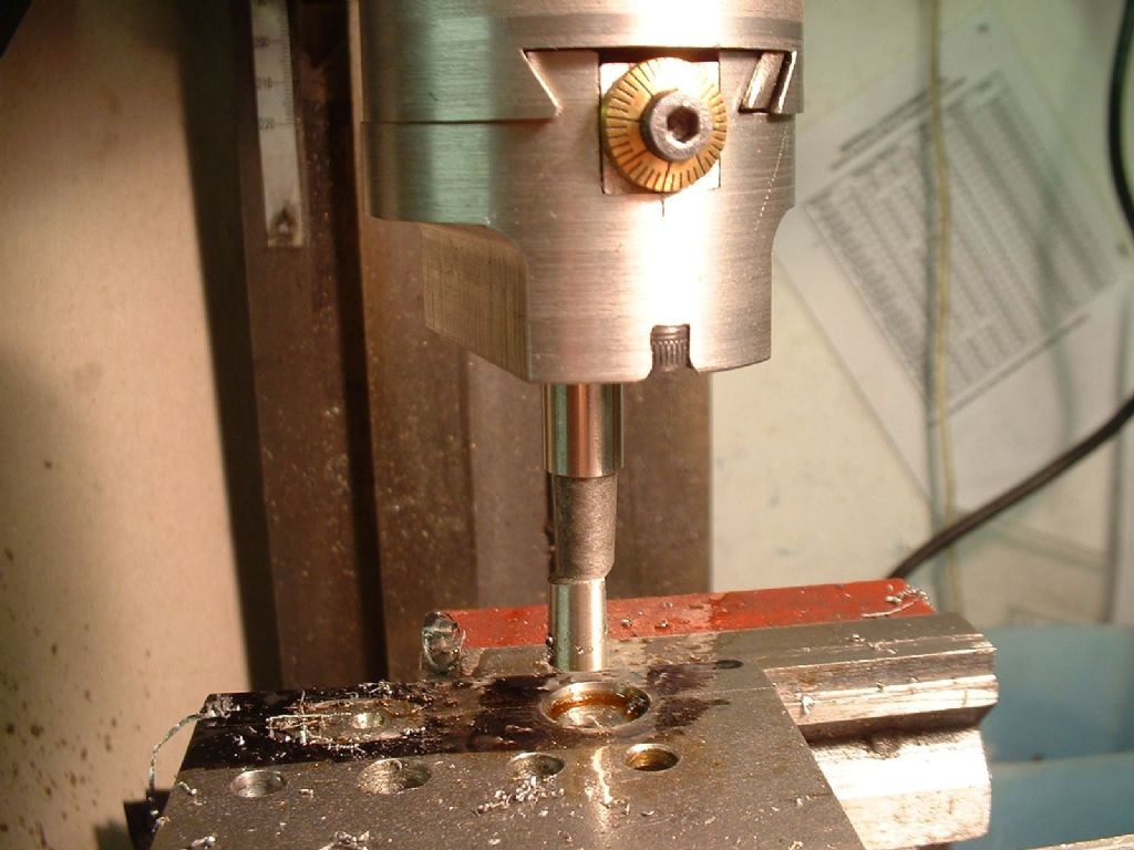

                #239335
                  I'd better respond!
                  The position of the threaded hole is closer to the dial assembly as is clear from the exploded diagram. This makes assembly easier. The views of the body are 'upside down' compared to the exploded view.
                  As Jon's images show this give plenty of usable travel – I don't think it would be wise to wind the upper part out further than his pictures show.
                  Nice to see pictures of things made to plans in the magazine. Any other examples (not just boring heads). Here's the original doing a job of work:
                  #239338
                    I'd say the M5 tapped hole if 5mm off the ctr line of the head as it falls between two of the gib adjusting screws which are on 10mm ctrs

                    Jon Gibbs
                      @jongibbs59756
                      Posted by Neil Wyatt on 19/05/2016 16:06:26:
                      Neil,
                      Thanks very much for the response. I guess we're only talking about 10mm between the two positions (5 mm either side of centre as Jason says) and the following comments are with due deference to the designer of course smiley
                      1) On my version, at least, the assembly limiting factor seems to be the leadscrew length since that has to be withdrawn fully out of the way to allow the leadscrew support to be inserted into the 7mm hole in the slide without interference. I can see that it'd be easier though with more than a fraction of a mm of clearance.
                      2) I positioned the leadscrew nut on the far-side of centre to give a combination of enough clearance to insert the leadscrew support but to also provide maximum travel because I think that occurs when the leadscrew nut is hard up against the leadscrew support?
                      I guess that there is perhaps more leeway to its position at the end of the day than I thought but perhaps there is also a bit more travel than originally planned as well?.
                      Jon
                      #239343
                      I.M. OUTAHERE
                        @i-m-outahere
                        Looking at fig 3 the holes for the boring bar lock screws are at 10mm centres and the drawing shows the centre line of the hole for the leadscrew nut runs halfway between the centre boring bar screw hole and the outer one so 5mm off centre and on the opposite side to the lead screw dial .
                        This would give 12mm travel when turning the leadscrew clockwise from the point where the head and slide align , you would have around 3.5 mm of the end of the leadscrew protruding from the leadscrew nut at this point and this gives you some movement to turn the leadscrew counterclockwise from the point where the head and slide align .
                        This can be usefull for tool overlap when using the boring head to open up holes that start out fairly small and you have to change the position of the boring barfrom the middle hole to the outer hole to achieve the larger hole sizes as needed – but as with all things it comes at the cost of losing some boring diameter which can be worked around using a different way of mounting the boring bar in the boring head
                        Neil, how is assembly made easier having the leadscrew nut on the same side as the dial ?

                            #239372
                            I.M. OUTAHERE
                              @i-m-outahere
                              An adjustment of my previous post is needed !
                              The locking screws at 10mm centres are for the gib strip not the boring bar and the inner boring bar hole is not on centre but off set 2.5 mm towards the dial end of the slide , sorry i was flipping back and forth between this forum and pocket mags to check the drawings!
                              Neil , i would have though assembly to be the opposite to dissassembly – well that is what my Gregorys' car repair manual would leave one to believe !
                              I thought that the assembly of these components would be very similar to that of the lathe cross or compound slide on a sieg C2 lathe , slide the dovetails in until the nut hits the end of the feedscrew then turn the feedscrew counterclockwise until you feel the threads click and then wind the feedscrew into the nut – if that doesn't work pound it into submission with the biggest hitting implement you can find !
                              Ian

                                #239941
                                I.M. OUTAHERE
                                  @i-m-outahere
                                  Neil, now i see what you mean !
                                  Having the slot open would allow swart and dirt to get into the area that is supposed to ptotect the leadscrew thread also .
                                  If i'm getting this right the outer boring bar mounting hole( furthest from the dial ) will give you the maximum bore diameter with this boring head when the slide fully engaged in the dovetail ?
                                  Ian.
                                  #239958
                                    You can move either side of centre. Lets call 'in' when the dial is screwed clockwise and out when it is screwed anticlockwise.
                                    A small movement in allows the middle boring bar to move to being central, smallest setting.
                                    When wound right out the central hole will bore bigger diameter than the outer hole, so their ranges overlap – this is intentional.
                                    Wound right in the outer hole is beyond the edge of the boring bar body allowing holes over 2" diameter to be bored.
                                    Essentially it is set up so that despite limited movement you can still work from the size of your smallest boring bar up to 2"/50mm.
                                    Bear in mind that the practical limit depends on how firmly the slide is supported when wound out, so extended movement is not really wanted.
                                    You can always add a horizontal boring bar hole for really big diameters. With a stubby bar just protruding you could get down to just over 50mm, and maximum diameter depends on what sort of overhang you dare risk!
