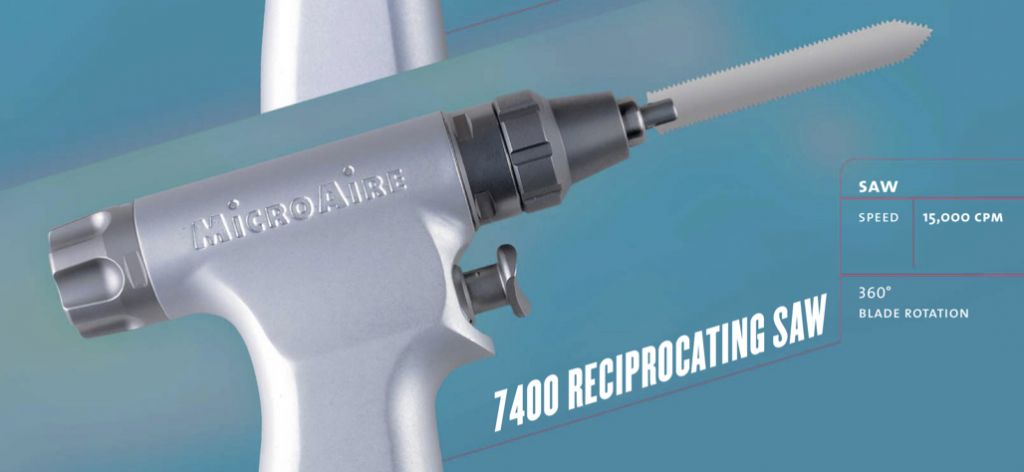

              Here, from that brochure, is what the business-end should look like:

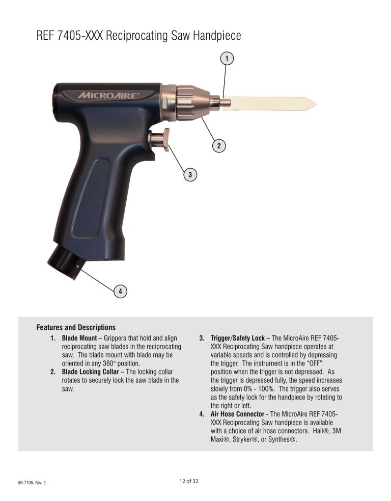

                    https://www.microaire.com/medical-professionals-2021/
                    https://www.microaire.com/wp-content/uploads/2021/08/IM-7105-Rev-E.pdf
                    … from which:
                    Edited By Michael Gilligan on 19/04/2022 15:22:01
