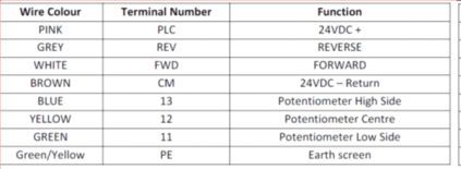

      Just read the article about fitting a Transwave inverter/motor kit. There appears to be a diagram missing illustrating the connections for the remote unit. It refers to it in the text, then there's a blank line ……….
      Presumably the supplied instructions with the kit include this?

          I think this is it. It was included in the draft text and not supplied as a separate drawing and when reading the text I assumed it was referring to one of the photos.
          Yes their packages come with all full instructions, but without the humour.
