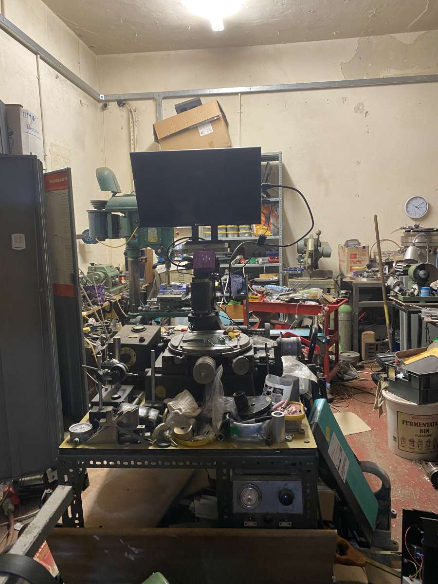

      Hi All,
      I have an engineers microscope (OMT.. rebadged Zeiss Jena?) to which I have fitted a 50mp Chinese camera, a TFT screen and output to a mini PC (Win 11).
      Can anyone recommend free or cheap measurement software?

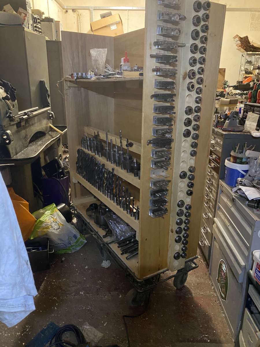

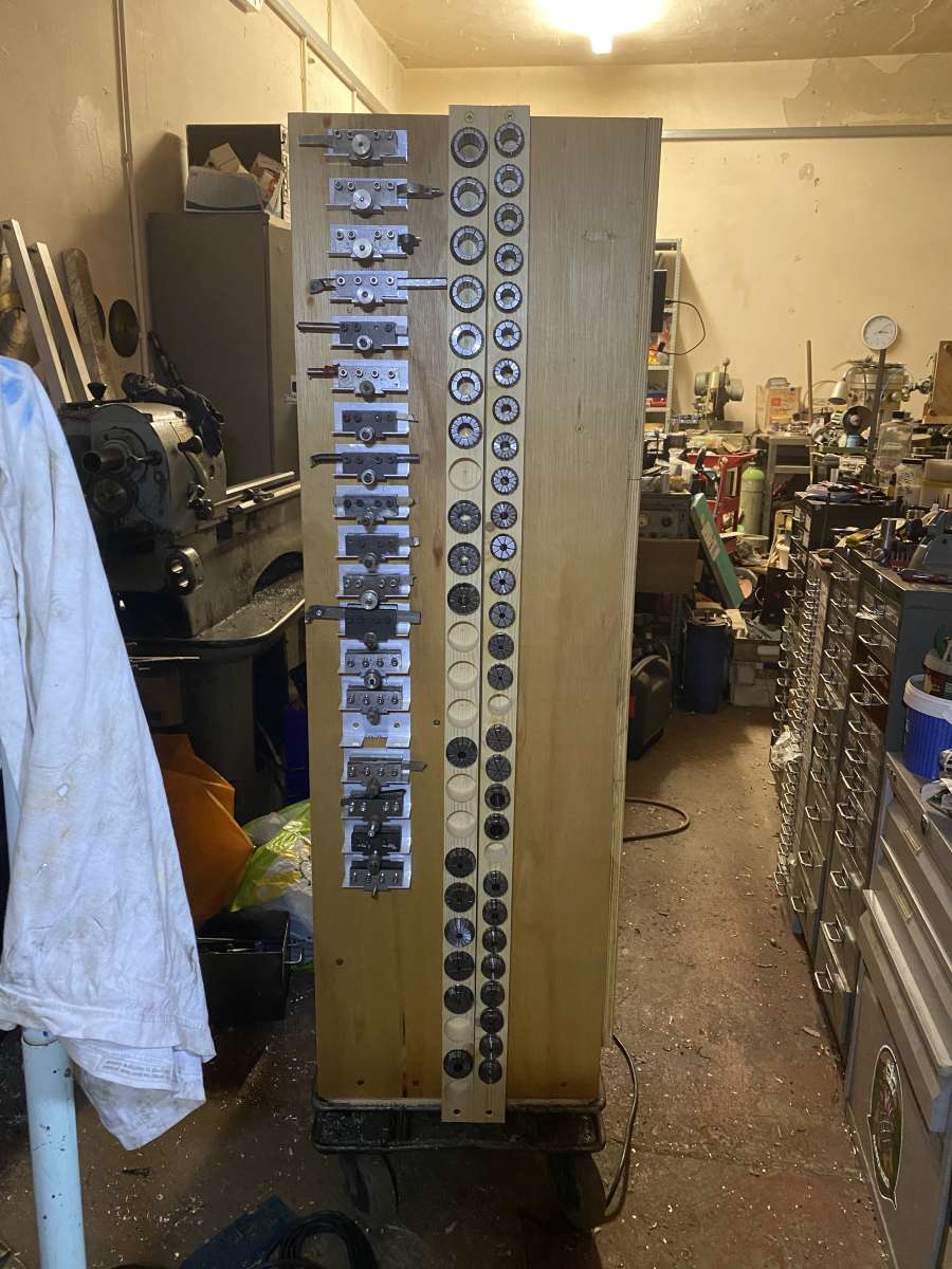

                            Here’s some pics of the err… “workshop” or “death trap” as I might call it.
                            The not yet complete “Tower of Power” is a feeble start at trying to be more organised.
