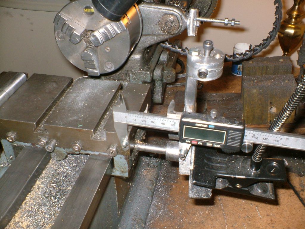

                    With one evenings work all these issues disappear forever with the simplest most useful mod you will ever make to your old lathe
                    Fit a $10 digital caliper to the cross slide
                    It also eliminates measurement backlash issues, good to around 100th of a mm, simply press a button to do metric or imperial
