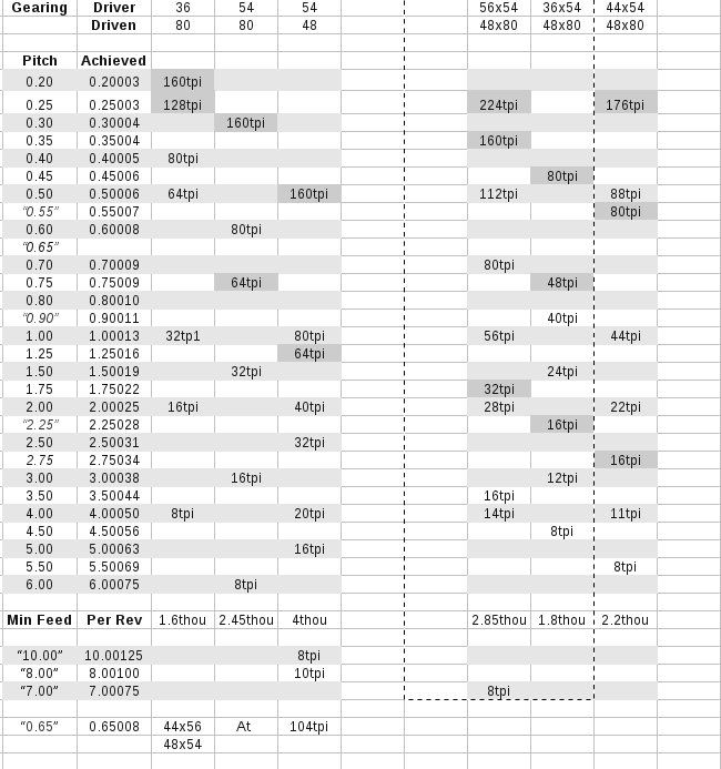

                I've found in the past that both of these applications work
                **LINK**
                It's been a long time since I used either of them but vaguely remember that one has a precision setting and that it's worth playing around with that. I only used the with gearbox one and I may be confusing usage with something else.
                On Boxfords the 100/127 gear probably has more merit on lathes that do not have the screw cutting gearbox. Where lathes have the gearbox there isn't much point in buying it – eg one of the charts in my album
                If some one wants to produce charts like this on lathes with the gearbox it can be worth forgetting 100/127 etc and producing a spread sheet that works through all of the pitches the lathe can do and then trying combinations of different change wheels driving it. Curiously they seem to have inbuilt ratio's that help obtain very close approximations.
