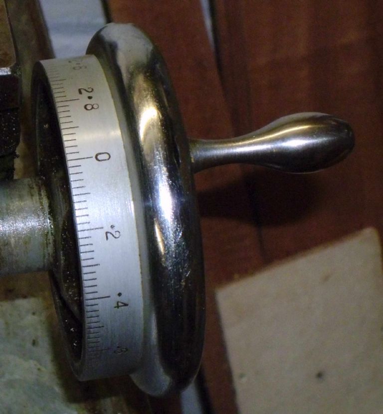

                  Here's a picture of the leadscrew handwheel off my lathe (it has been converted to CNC so the wheel is replaced by a timing pulley). You can see that the calibration runs from 0 round to 3.0 x 0.2mm, then there are 5 x 0.2 mm divisions to 3.1; then 4 divisions back to zero, the last one being slightly bigger. So you can accurately feed the carriage along using the l/s handwheel by up to 3.16 mm but after than it's a guess! I believe the calibrated handwheel is standard on the S7, so if yours looks the same you will know it's an 8 tpi thread, whereas if it is truly metric it would count a whole number of mm in one revolution. (Though 3 mm wouldn't make for the easiest threading etc – 2.5 mm would be better IMHO).
                  When I first started using the lathe I didn't realise the screw was 8 tpi until I tried to use the leadscrew to set a dimension greater than 3 mm accurately!

                    Myford 7 series lathes all have Leadscrews that are 8 tpi (1/8" pitch), that's why the imperial handwheel reads 0 to125 and the metric handwheel reads 0 to 3.18mm (1/8" = 3.175mm)

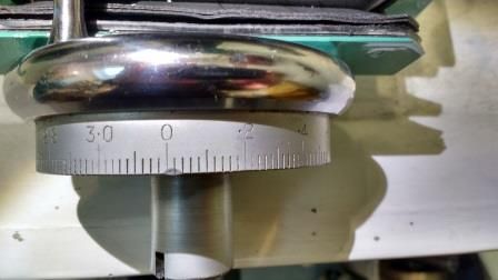

                                    This is the metric handwheel on my Myford.
                                    #222487
                                      Posted by John Caines on 25/01/2016 09:11:30:
                                      Well … That is certainly designed for a 3mm pitch.

                                            I see that Michael Gilligan's 10 has top slide and cross slide feedscrews threaded 3/8" x 2mm pitch to go with its hybrid leadscrew.
                                            Also interesting that John Caines' handwheel has intermediate markings which omit the leading zero eg ".2". Is this normal practice for metric leadscrew handles?

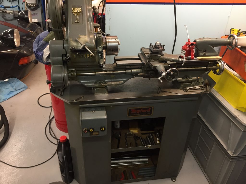

                                              Arnljot Seem
                                                @arnljotseem72268
                                                Hello. I just want to thank you all for the help with my metric vs imperial question. Below is a picture of my well used Super 7 lathe, that I am gradually restoring. Also a picture of my first ever lathe "project"; using the answers from this forum, to cut an M8x1.25 mm thread. Since I was missing the 40T which is used in many of the metric standard threads, I found this table very useful in finding other gear combinations to cut the same thread. http://www.homews.co.uk/page30.html
