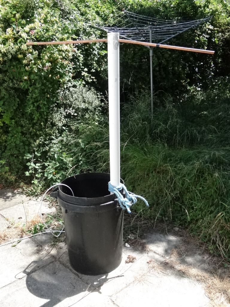

                              The closer you get to Graves the more likely you are to see aircraft. But from this distance from the ground station we can only see things more than about 25km high.
                              Last night the moon might have been detectable, but the distances require a better antenna than mine:
                              Yes that is a dustbin, old drain-pipe and second-hand plumbing. The rotary drier isn't part of the installation

                                  Posted by SillyOldDuffer on 22/06/2018 13:14:10:
                                  But it looks more impressive
                                  http://www.britastro.org/radio/projects/Antennas_for_meteor_radar.pdf
