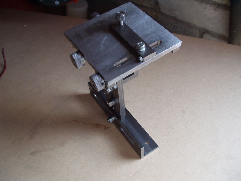

        I’ve been looking at a couple of Harold Hall’s books in the Workshop Practice Series with the intention of building a Grinding rest for Tool & Cutter sharpening. He specifies using 070M20 steel in one book & 230M07 in another book both in metric dimensions. I’ve looked up these steels and think I understand the principle difference is in their milling capability.

          I use en1a for most things(including this
          have you looked in yellow pages for steel stockists?
          I found one near me in Norwich and he is waaay cheaper. He’ll cut off short ends as well.
