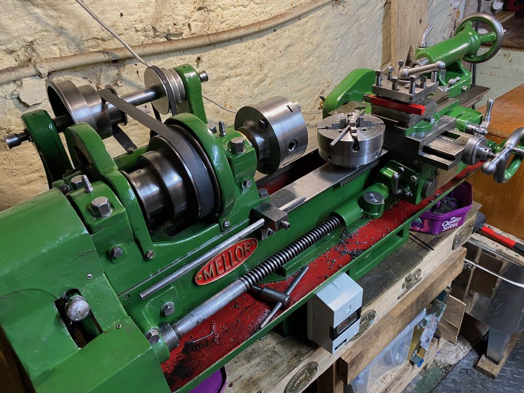

                          David Noble
                            @davidnoble71990
                            Morning Paul,
                            I'm just coming to the end of the same project. I'm happy to help if I can.
                            Here is where I'm up to.
                            David
                            #640030
                            Paul Relf-Davies
                              @paulrelf-davies37806
                              Hi, David,
                              That machine looks great…
                              As I said earlier, mine is mostly complete, really just nedig a thorough clean and reassembly, to be ready for use.
                              I don't have the original struts used to support the lay-shaft, so I'll need to fabricate something to replace them. U'm thinking of incorporating a drive belt tensioner mechanism so I can easily adjust the tension and release it for ease of changing pulleys (mine used a V-belt, rather than a flat belt).
                              Apart from that, I need to make the lever that (I assume..?) operates the power feeds as well as the gear, cone clutch and wing but which control (??) The power cross feed.
                              Could you confirm how the power feeds actually work, pls? I assume the possible modes are: power feed off; carriage feed on/Cross feed off ; Cross feed on/carriage feed off? How does one engage each state?
                              As an aside, I like your carriage stop…I made something almost identical for my other lathe. I use 2 rods..one plain, like yours, as a basic hard stop for repeatability, plus a second that holds a dial indicator for turning to an accurate dimension.
                              Cheers
                              Paul
