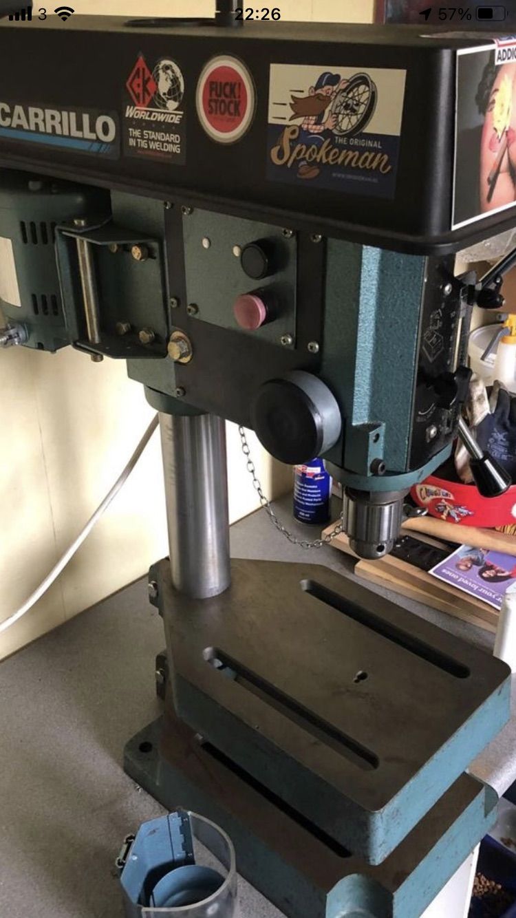

      Could anyone please give me an idea of the value of this Meddings drill. It would a good condition and was fully serviced about 3 years ago when it was bought from a college. It is up for £700 and I am looking at this or a new Axminster Trade drill at £500.00
      It will mainly be for small projects using timber and aluminium.
      Many thanks

                You’re welcome, Martin … and, if it was my choice, I would invest the extra £200
                Other opinions will doubtless be offered.

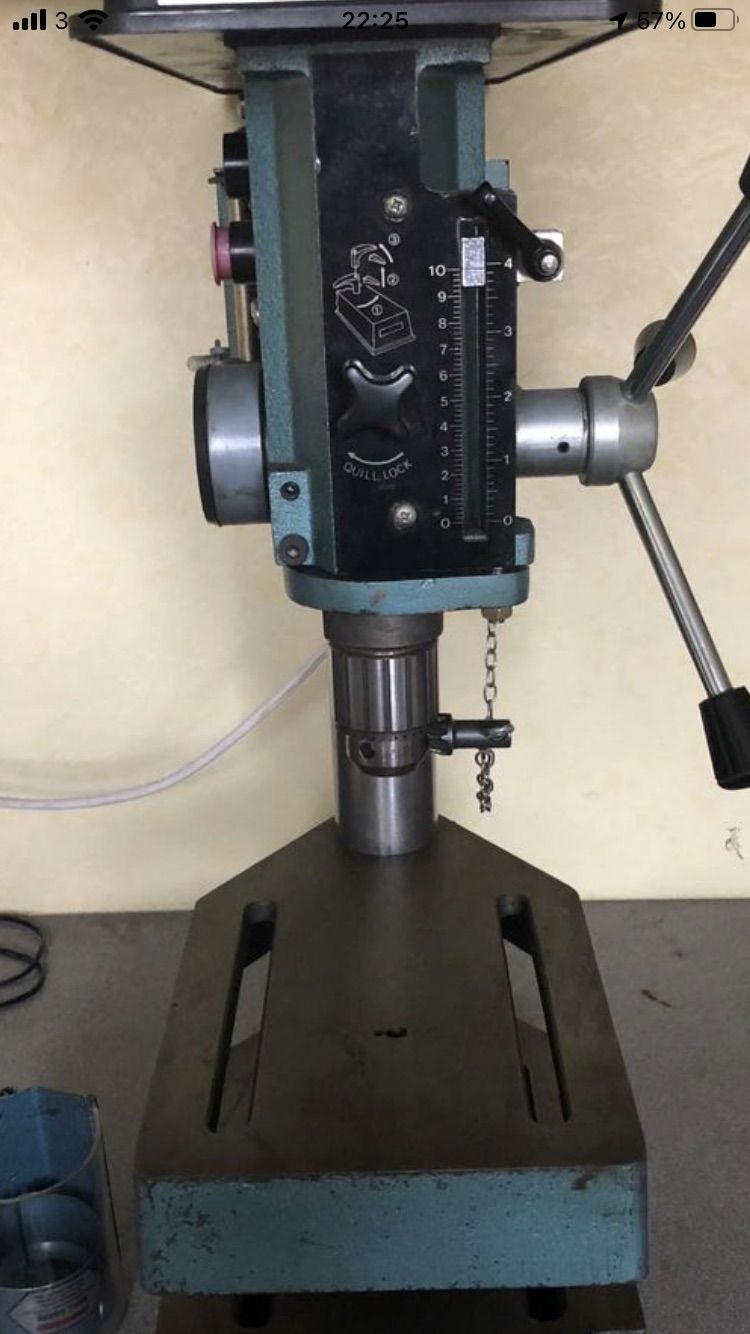

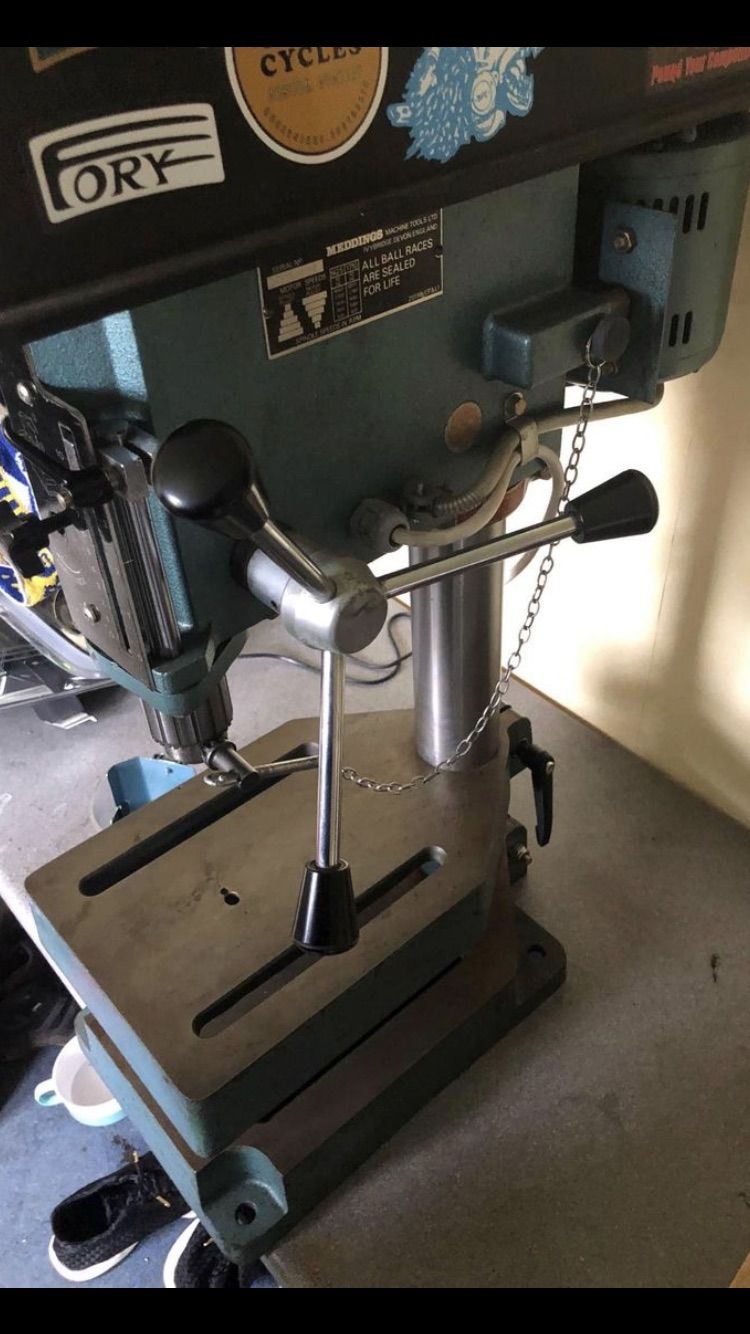

                  I'd go for it.
                  I have an identical machine, it is well-built, and though its low speed is a bit fast for its largest drills in steel it will be fine for wood and aluminium. It does almost all the drilling tasks I need. (I have an old and well-worn Elliott Progress 2G for the lumpier work.)
                  I'm impressed too – only one rogue hole in the table (the small one)!
                  Though I wonder if the larger central hole was not original but an owner's modification to allow drilling though. Mine lacks that so when drilling a directly-clamped item I swing the head round to make the drill go into the T-slot – test the clearances first! My preference is to leave the head locked and move the work-piece along a guide-bar.
                  The one disadvantage I find on mine – yours may differ – is that the head does not lower as much as it might, so using small drills sometimes needs the work or vice raising on blocks. This happens because the machine is assumed to be secured to a solid bench top, so the elevating rack is not made to pass through the base.
                  That apart, I am very happy with my Meddings.
                  My T-nut sets are the common 3/8"-UNC ones readily available from our usual suppliers – but if you use them, be judicious as their load-bearing steps are a little bit too narrow for the machine's T-slots.
                  That big flat table is a good surface-plate too!

                        The Meddings sounds a bit on the high side to me at £700, nice machine went at auction this week for £350 + "the drip" so around £400 or so.
                        May not have been like for like but a large difference. Is it warranted good?

                          To my mind that looks a very nice condition drill. If that has come from a college it does not look as though it has been abused. It has what appears to be the original hole in the table and one extra unintentional one. The paint looks in good condition with very few chips or dents. The chuck key is sitting horizontal which to my mind shows the chuck is not very worn, had it been the key would tend to droop in a worn hole. Style wise it looks quite recent. Current Meddings bench top drills are over £2100. You could check the serial number with them.
                          If it was me I would be going for it. It would be worth trying to get the price down a little if you could.

                            My only comment, is never trust someone who leaves the key in a chuck…

                                My view is similar to that of Martin King. £700 is top money for a machine like this, the sort of price you might expect to pay to a dealer. Privately you might expect to pay half this price. I would also prefer a machine with a rack to raise and lower the table.

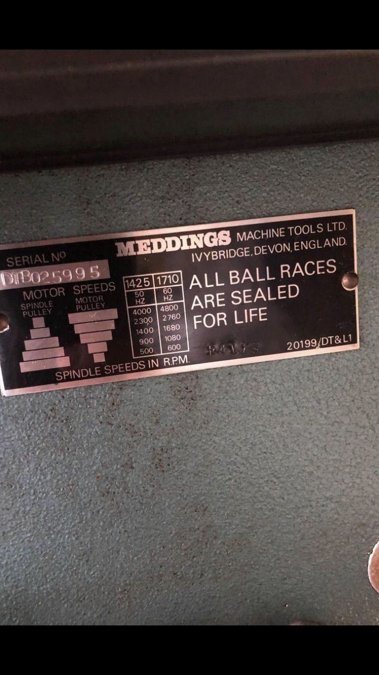

                                      I actually have the same drill as that on my workbench, not anywhere near as nice though, but I did pay £52 for it.
                                      I also had a Startrite I gave to my father, I'd say the Meddings is the better made machine generally, although the startrites go for silly cheap money and are excellent drills.
                                      As for the service? service what? the plate on the side says "all ball races sealed for life"
