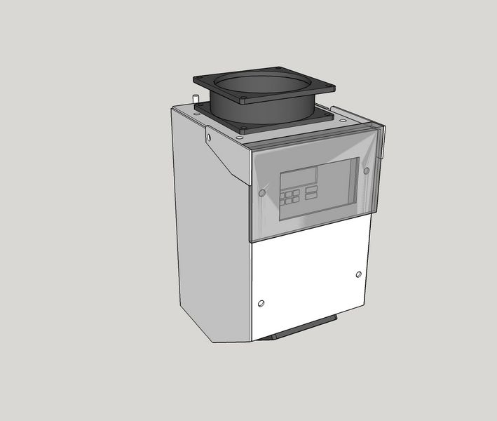

      One thing I haven't worked out yet with this design is how to easily make and fasten a window on the front. ideally it will be openable so I can get to the inverter buttons.

          Nice work with the SketchUp model, Toby
          First thought for your 'window' was to insert magnets … but swarf & cast iron dust may be a problem.
          … I would probably just let it slide in a couple of grooves [a bit like a portcullis]
          https://en.m.wikipedia.org/wiki/Portcullis

                  MichaelG: Thanks, I think you are right, magnets and swarf will become a problem. I did think of velcro but that might have similar problems. I like the idea of the portcullis but wasn't sure how to easily stop it dropping on my fingers.
                  Anyway, after a bit more playing I have come up with this:
                  So it will lift up and rotate over the top, resting upside down on top of the fan. I need to double check my pivot points and arm lengths etc but I think it is roughly right as shown.

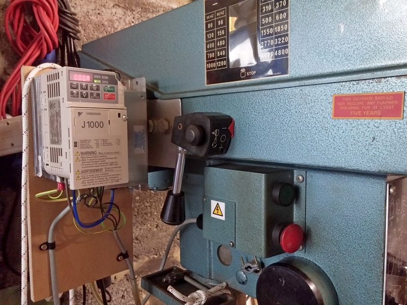

                    Thanks for the compliment on my installation, there are a number of shortcomings in it but it is OK for my own purposes (it would not be acceptable for an industrial application).
                    I know you are only using the line in filter but I thought I would put the picture up to show what is needed for a fully filtered setup. The two large filters are the drive side chokes (drive reactors). They take out all the horrible digital synthesised waveform and turn it into a close approximation to a sine wave. I imagine that my installation would be significantly safer for Michael than an unfiltered arrangement! There are a lot of armature electronic engineers on here (and a few professionals I suspect from reading some posts), any of them with access to a oscilloscope can see for them self what the output looks like without a choke and then they can see the improvement if they buy one.
                    You might also notice I am using the cheap Hungyang inverters – I like them!

                        If the vfd control panel is very close to the cut out (or in line with it) then a soft clear plastic cover should do the job. Something like the flexible plastic on a see through umbrella, or fold up map cover etc.
                        Steve

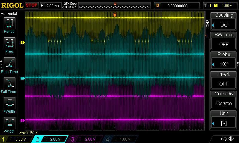

                          Mark: You are right about the noise generated on the motor side. When measuring phase voltage and noise on the system we are currently developing I need to put the signals through an R-C filter just to make something meaningful from them.
                          Just to give people an idea how things work, this is a trace I took of the pwm switching signals to the output transistors on a VFD. If you squint you might just work out there is a sine wave in there somewhere
                          put through an RC filter you something more meaningful……
                          Steve: I like the soft plastic idea although it might challenge my metal bending skills trying to get the panel close enough to the front of the VFD

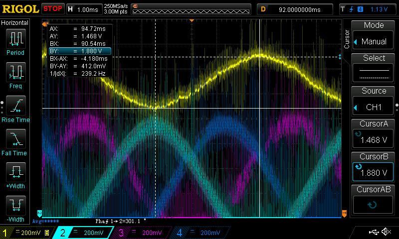

                              Toby, the my output is better than that after a choke (I realise you are measuring the transistor drive voltage so it may well be different). I don't have any traces from the scope but the biggest error I saw was the shape of the wave (it was a little "stepped" and there was some offset or dwell at zero crossing).

                                Looks good to me, Toby yes

                                  … to show what is needed for a fully filtered setup. The two large filters are the drive side chokes (drive reactors). They take out all the horrible digital synthesised waveform and turn it into a close approximation to a sine wave. I imagine that my installation would be significantly safer for Michael than an unfiltered arrangement!

                                      A good point. Yes, to avoid confusing others, that top trace I posted is the input to the final drive stage of the inverter. The output will be filtered, either internally or effectively by the motor, so will not be anywhere near as bad as that. I just posted it to show how much electrical noise there is internal to the inverter. How much of that gets out (either to the motor or back through the supply) depends on how good the filtering is – both internal to the inverter and external in the form of EMC and output filters.

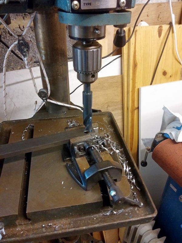

                                        I realised I had not updated this with the latest progress – the inverter is temporarily on a bit of ply so I test everything out but wired into the original start/stop switches.
                                        Yes, I know the wiring is not exactly to the regs but it will get done properly when I put it all in a box, honest!
                                        After a bit of playing with the inverter settings I was ready for some drilling. First a 10mm drill through 10mm of steel, then follow that up with a very cheap 20mm blacksmith drill. The drill was visibly blunt but it didn't even break a sweat, even when leaning on the star handle I could only get the current indication on the inverter up to 1.85A (no load is 1.7A). IIRC this was on 300rpm.
                                        I do think I need a bigger drill vice though….
