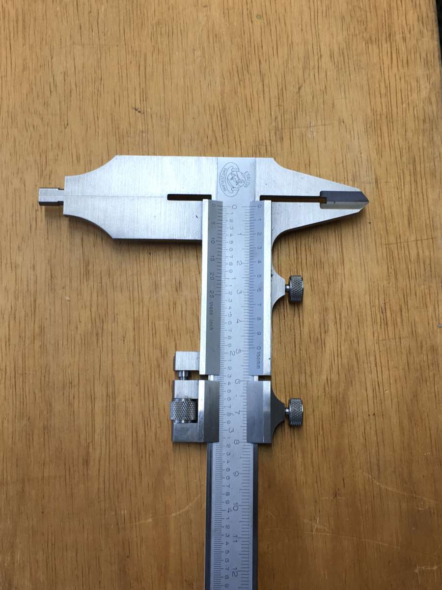

                          On Vic Said:
                          On JasonB Said:
                          Cheap pair of callipers with the edges rounded over would protect the wood, just set them to zero in a known gap  and adjust the final reading taking that into account.
                          I did think of something like this. You can buy round tips to retro fit calipers as well. It’s a shame they don’t make calipers with rounded tips.
                          Vic, you mean something like these ?  Rounded tips that are in this case 0.250″ to add to the vernier reading. some were 0.200″ they would in most cases measure across several thread crests.9753E91F-F7BD-4415-A010-9FDFDA9F5837
