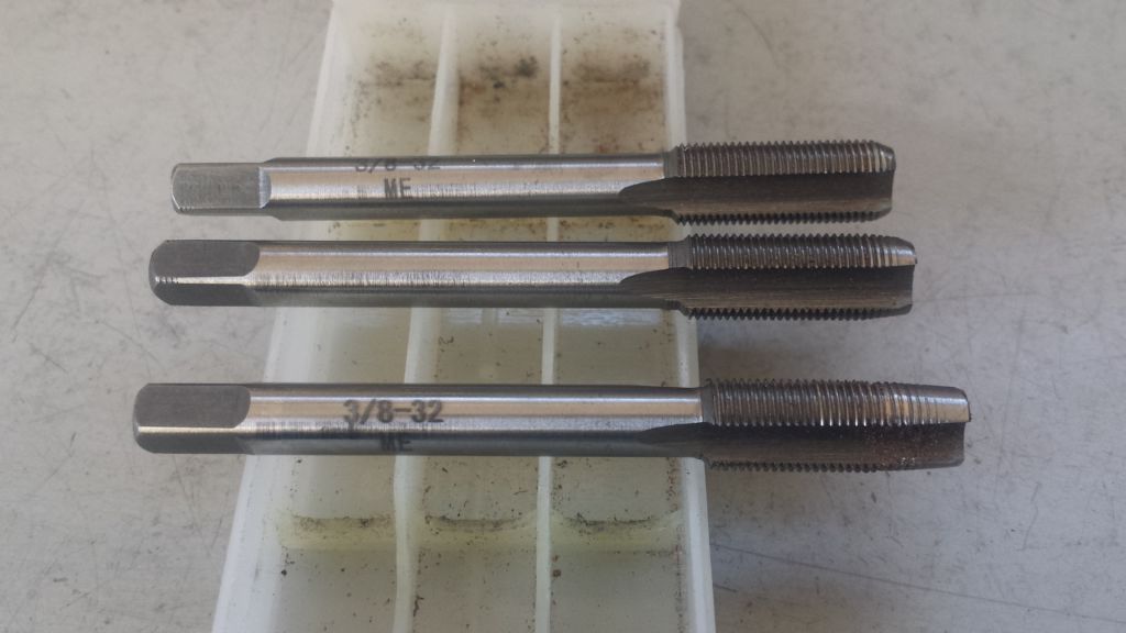

                Andrew, you know Fred, it was him and he could not even get the taper to go more than a few turns into an 8.8mm hole, though I did think it looked a bit iffy just before it gets to full form.
                "I increased the hole to 8.8mm and the taps still will not go in. That is using a No. 1 first. I just don't understand Fred "

                      I've got a couple of ME style taps from Tap&Die and they've been fine. I wouldn't pay any attention to the chart on the website. I'd put more trust in the figures in the book by Tubal Cain.
                      If Fred's taps don't work in a 8.8mm hole then I suspect the taps. Certainly the taper tap grind looks odd; almost as if the leading edge of what should be full depth threads has been ground off.

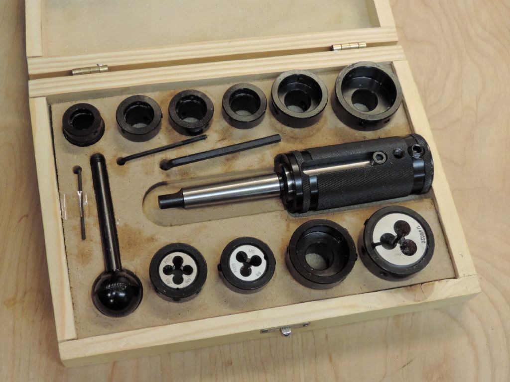

                                        #379609
                                          Posted by BOB BLACKSHAW on 07/11/2018 12:21:53:
                                          Mark, I only die max 12mm so no need for point threading.
                                          My ARC tailstock holders only have two screws so no adjustments can be made.
                                          Why only two screws on the ARC tailstock holders.
                                          Bob
                                          Are they quite old?
                                          These are Arc and have four screws:
                                          Sorry for the picture quality, but the ones for my Arc turret have five:
                                          Edited By Neil Wyatt on 07/11/2018 15:46:18

                                          BOB BLACKSHAW 1
                                            @bobblackshaw1
                                            Neil,
                                            Mine are not so sophisticated as the photos, the ones I have are chuck held and three year’s old.
                                            Bob
                                            #379613
                                              Ah, I see them.
                                              Perhaps they are originally designed to be used with non adjustable dies.
