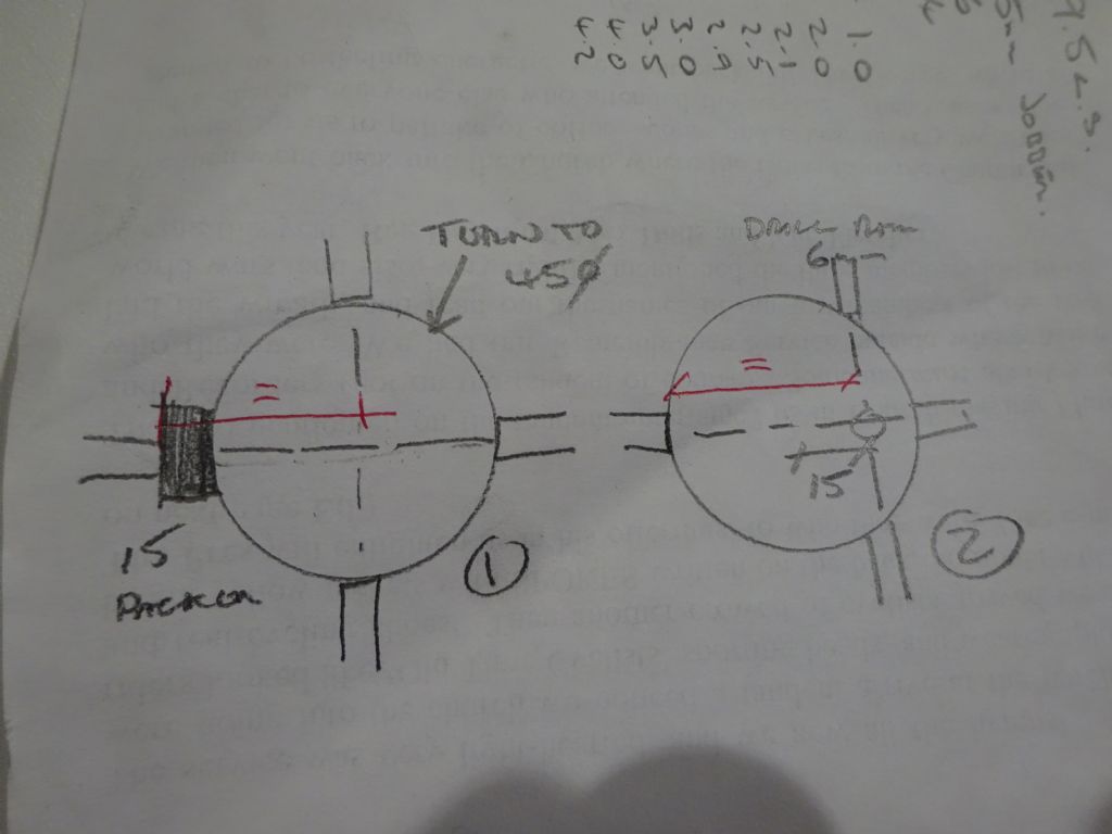

      I quote from the beginning of this text about making The Middleton V-4 Oscillating Cylinder Engine:
      Machine the crank discs from a piece of 2 inch or 50mm diameter steel. Place the metal in a four-jaw chuck, but in one jaw, place a 15 mm thick packing piece (for the throw) (photo 15).
      Clock the bar to make sure it is running true, turn to 45mm diameter …
      The picture (No 15) shows the bar concentric with the tailstock centre, and in line with the lathe bed.
      Running true to what? And how can the bar be in line and offset 15mm while lining up with the tailstock?
      Sorry, I just don't get it
      Cheers, Tim

          Tim, have a look at this post about the middleton from yesterday.
          If you read on he then says undo 3 jaws leaving the one that had the 15mm packer untouched, remove the packer and then retighten the other 3 jaws. This will have the effect of offsetting the bar by 15mm so the pin hole can be drilled and reamed

            What a strange way to set something in a 4 jaw. Unless the jaws shown top and bottom are tightened equally the offset won't be 15mm anyway (it won't be far off admittedly). If I didn't mind a small error I'd use a bar square to find the centre, centre punch off centre and set up to the punch mark. If I wanted it more accurate I'd do as above then fine tune using a DTI
            Mount DTI on cross slde touching work
            establish max as in picture above, rock spindle to and fro to get exact max
            set DTI to zero
            move the cross slide back by 15m and check min position.
            If DTI not zero adjust and repeat

                It is a pity that nowhere does it say anything that hints at this odd (to me) way of determining where a hole should go. The words 'Take the … packing out, tighten the three jaws up, drill and ream' might have continued 'to make the hole for the crank pin.
                Is it not possible (or even easier) to part off the three discs and Then drill a centre hole in each, fit a tight pin, and drill the offset holes together? The idea of offsetting a chuck jaw and relying on that to position the offset hole, is what seems odd. It would even have made more sense (to me) if the jaws had all been in contact with the bar for the hard work of turning and parting off, and the required offset had been achieved by using the 15mm piece to create the offset as the next operation.
                Looking at the whole article, the major confusion (for me) arises because of the extreme brevity of the instruction. The three words 'for the throw' carry the whole burden of explaining the sequence. 'Drill and ream' adds nothing as we are not told what the hole is for. But the actual effect was to sow the seeds in my mind of turning the crank from solid.

                      Tim do you only read the text and not look at the photos and drawings? From these it is obviuosly a built up crankshaft.
                      If we were to need word for word descriptions of every single step of machining a part the articles would run for months, authors have to assume that people making these engines have some ability to think for themselves and relate what is said in the text to the drawings.
                      As I said in the other thread I could follow what was being described but not how I would persomally have done it. Probably face the end of the bar and then set height gauge on cross slide, mark ctr height then rotate chuck 90deg and put a second line 15mm above ctr. Punch with optical punch and then set punch mark to run true.
                      The text as sent in for this article was very hard to follow as were the sketches, Diane (and helpers) have had to re-write a lot of it and alter drawings, think she has done well as a non engineer.

                        The only time I would use packing like that is if I was going to off set a piece in a THREE jaw chuck, part of the idea of a four jaw chuck is that you can off set an item with out packing.

                                Also should you not be seeing 30mm of total movement which would equate to 15mm on the dial if the cross slide were moved back 15mm.
                                If you are going to do it with a dti on the OD then a 0-50mm plunger type would be best and adjust the work until you see 30mm of movement, eliminates any errors in moving the cross slide and save having to wind it in and out a number of times. Both methods would only work with the dti spot on ctr height or maybe use an elephants foot end

                                    you're absolutley right, it should be 30mm, I forgot to double it. If you have a DTI with 30mm stroke by all means, none of mine do.

                                              Slight amendment to my last post, sometimes if the item to be off set in the 4 jaw is under a certain size, a bit of packing is needed on the jaw that is closed nearest , or across center, so that it doesn't foul on the jaws either side of it. Another way around the problem, and also to solve the problem of material too small for the 4 jaw to close on is to make a collet, just a bit of bar with a hole through it, and a hacksaw slot cut through one side(and if it's too stiff, half way through the other side).

                                                At last, after reading the explanation three times and going back to page 149 i see what he was doing. It's not the bar that's off set by 15mm but the chuck jaw. Definitely not the way I would do it.
