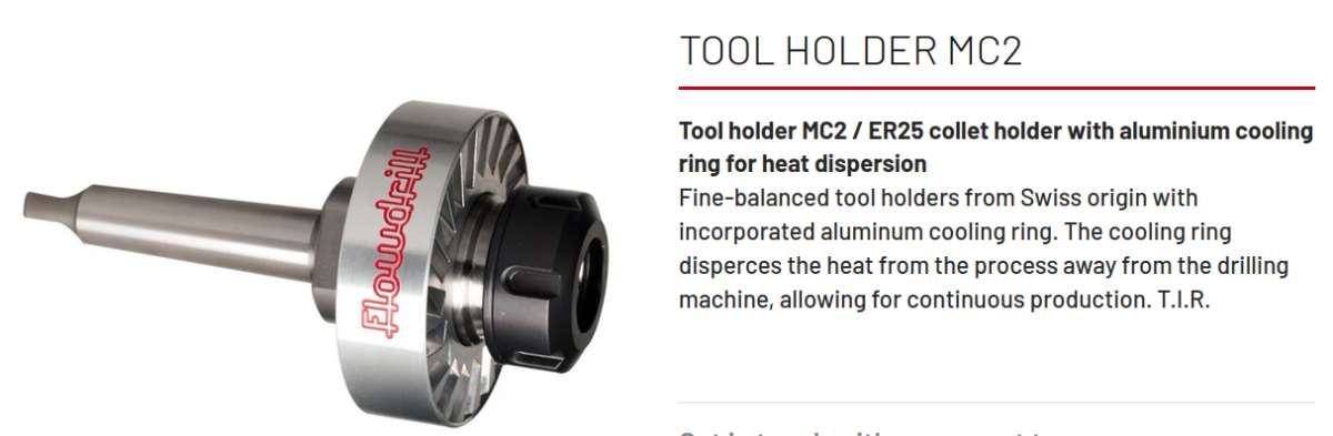

                        hbm-l-0076.jpg-1200x600-21695ebc88
                        #797666
                        davp1971
                          @davp1971
                          I lean these things.
                          <p style=”text-align: center;”>Best regards</p>
                          #797667
                          davp1971
                            @davp1971
                            <p style=”text-align: left;”>I mean these things.</p>
                            Best regards
                            #797688
                              Thanks for the photo, I was getting confused!   MC2 as a typo for MT2 made sense until Chris mentioned Burnerd and then I found this beast, also MC2:
                              mc2
                              An ER25 collet chuck working hard enough to heat damage the machine is new to me!  But production being brutal, there must be times when it makes sense to cool the chuck.    Obviously every Myford owner should have one!
