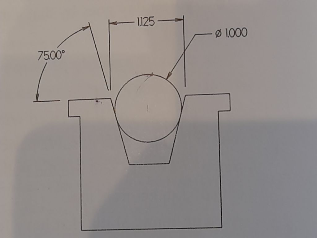

      I found this in a book yesterday and to be honest I can't work it out. I know the answer as I have a good CAD program. But what about you, can you do it the old fashioned way?
      How high above the surface of the part does the ball protrude?

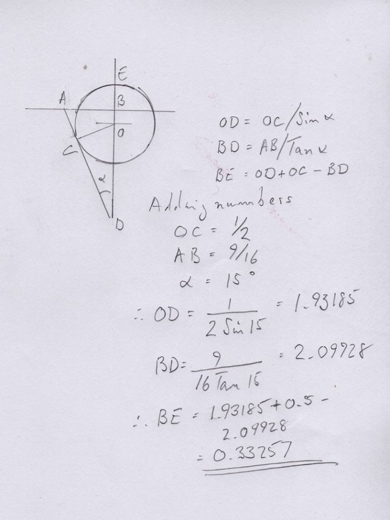

          99.4 thou if my maths is correct.
          If the slot width is 2W and the ball diameter = 2R and the angle of the slot sides to the vertical = A:
          The ball contacts the sides a height of R.sinA below the ball centre.
          The distance across the slot at the contact points is 2R.cosA, so the height below the top of the slot is
          (W-R.cosA) / tanA, giving the height of the top of the ball above the top of the slot as
          H = R + R.sinA – (W-R.cosA) / tanA
          For R = 0.5, W = 0.625 and A = 90-75 = 15, that gives the answer above.
          Shoot me down if I'm wrong.

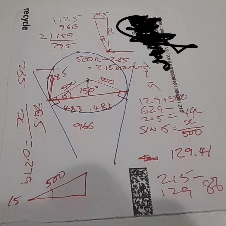

          #575551
            0.414"
            My method
            1. Work out how far below ctr of ball it makes contact 0.129 and also the horizontal distance 0.966
            2. Work out how far down the taper the 0.966 width is 0.215
            3 height is the 0.129 plus radius of 0.500 less the 0.215.
            Answer or at least my answer is 0.414

                #575556
                RobCox
                  @robcox
                  Jason, I agree with your method, but I get the height of the contact below the top (x in your diagram) to be 0.0795/tan15 = 0.2968, which gives me a revised answer of 0.3326.
                  Thank goodness I haven't got to worry about maths exams any more!

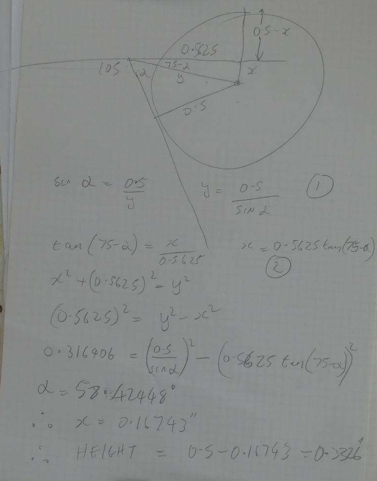

                        This is my take on the solution. It requires solving the equation to find angle alpha using trig identities which I did not include on the page as it is messy and seems a bit unnecessary to show here. The point is it gets the same result a different way from those above.

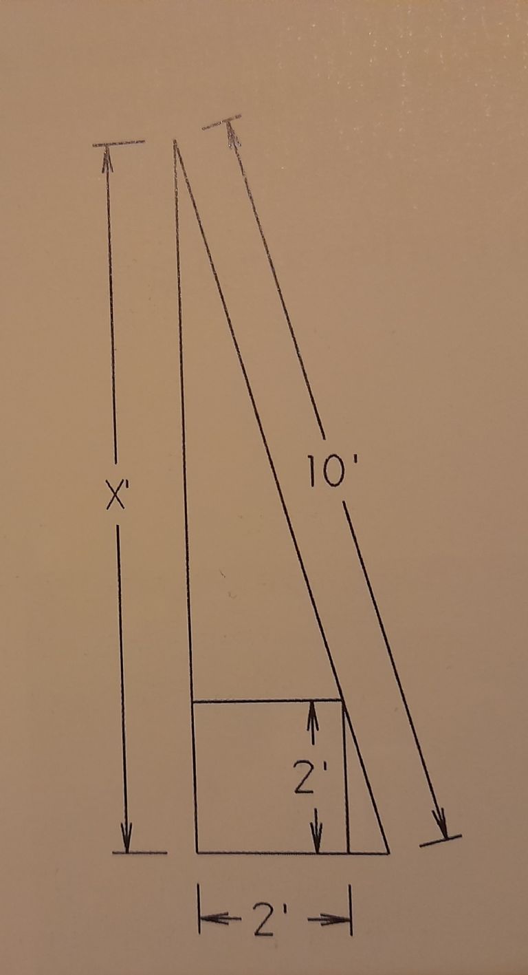

                            Well as Jason asked for it, here it is. I take no credit for this and I can't do it without CAD.
                            If the ladder just touches the cube how far up the wall does the ladder touch the wall? Good luck you'll need it.

                                    I coudn't do the box-and-ladder one but for sure it has two possible solutions. Only the visual representation (and the fact that no-one would use such a low-angle ladder) suggests that the base of the triangle is less than the height. Mathematically there are two values of X where the line meets the cube.

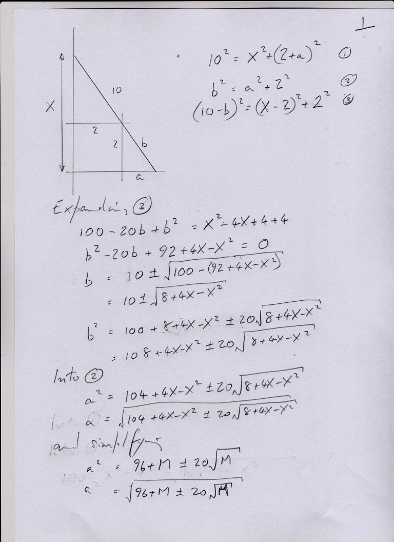

                                                    JA
                                                      @ja
                                                      My solution to the ladder problem:ladder 1ladder 2
                                                      Enough said.
