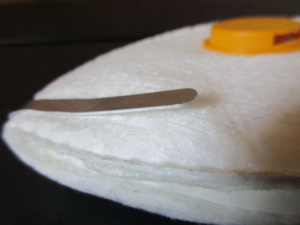

      A friend is making masks to wear in the community (don't want to start a discussion whether they are a good idea) and she is using a strip of tomato paste tube for the bending bit that fits on the bridge of the nose. But its a bit weak and doesn't fit the mask to the nose very well.
      Anyone know what metal is used in 'proper' disposable masks? I think its zinc based but not sure if its pure zinc or an alloy? Any ideas?

                                    Hi Mike Barrett, the photo below shows a new unused commercial one, the stripes are soft aluminium, you don't what anything springy or hard, because the need to be formed by the wearer to fit snugly. The one in to photo is 6mm wide by 1mm thick and is approx. 46mm long each side and only bonded to the mask by half the length each side to the mask.
                                    Regards Nick.
